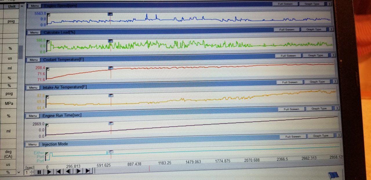

    Ok @OVTune
    2869 sec, which is 48 min of drive
    Flat effing line with one petty squirt.
    Start up to shutdown.
    Wanna debate further?

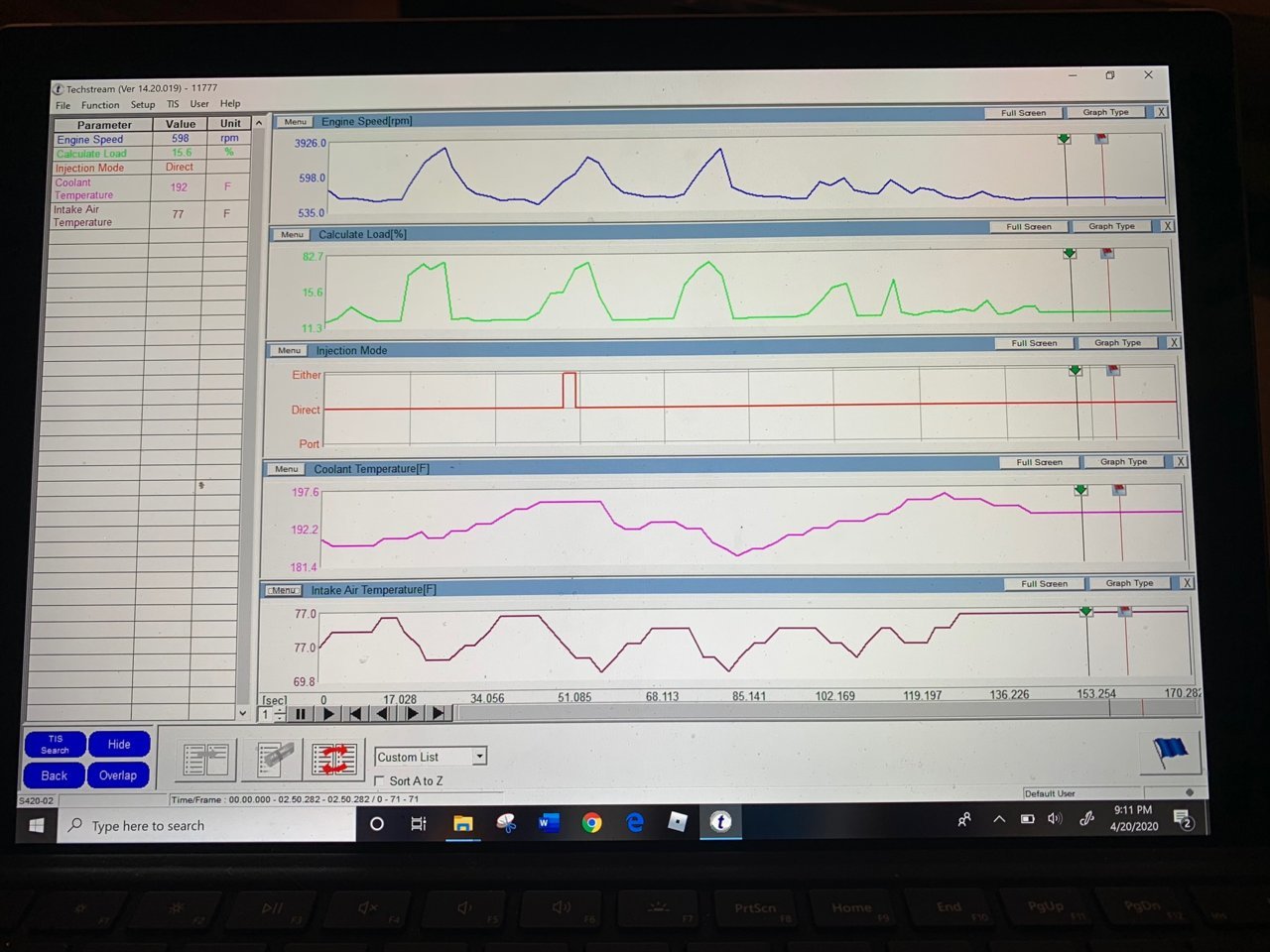

    DISCLAIMER: I just got techstream and have a whopping 30 min on it, and that includes the time to increase blinkers to 5 and turn off seat belt chimes.
    Anyway, trying to figure out how to collect the data the same way. Curious why your Injection Mode shows “Port, Port, Either”. Mine shows “Either, Direct, and Port”. I didn’t see a way to change that. Trying to learn this game so maybe I can provide additional info to the people smarter than me on this stuff.
    Here is a drive around the block. My truck was still kinda warm from my 30 mile commute home an hour or so earlier. I didn’t get it at startup but it was idling in direct from what I could tell. Will try again tomorrow.
    @OVTune I have ~200 miles on the new 2.0 beta. My cold start up is a little funky, starter seems to have to work harder and has an extra high pitched sound that wasn’t there before with the 2.0 19800. I’ll try to get video of it tomorrow. Running 2.0 91 31-33 no gears (265/75/R16 Cooper AT3LT). It did it this morning and again when I started my truck to come home from work. Doesn’t do it when it’s warm and has been running.

    The tune is 99% Direct injection. You got it right.
    Fun to drive, but not on my car.
