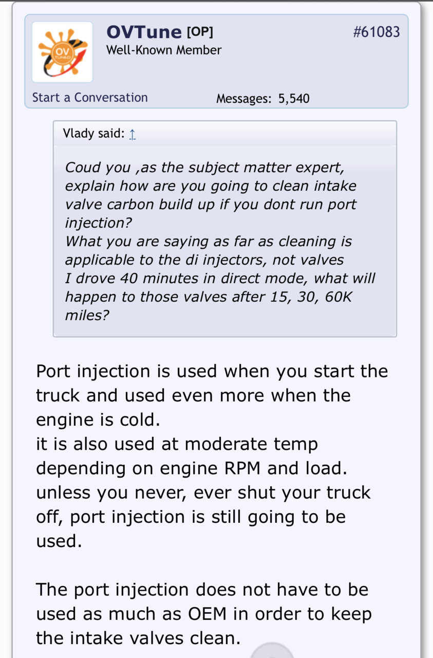

    Clearly this is opinion, because various people are responding in differnet ways, but can someone objectively clarify how often these injections should be happening with the 3rd gen taco specifically? I’d default to trusting OVTune 100%, but for the rest of us who are impartial (or in other words ignorant), is this something that’s even worth looking into? Any 3rd party outside of OVTune able to speak to this objectively with some insights from the data quoted above?

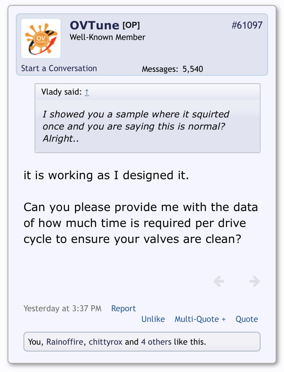

    we’ve been for @Vlady to specify the required values but shockingly that hasn’t happened. Mat has already said earlier today it’s working as designed.

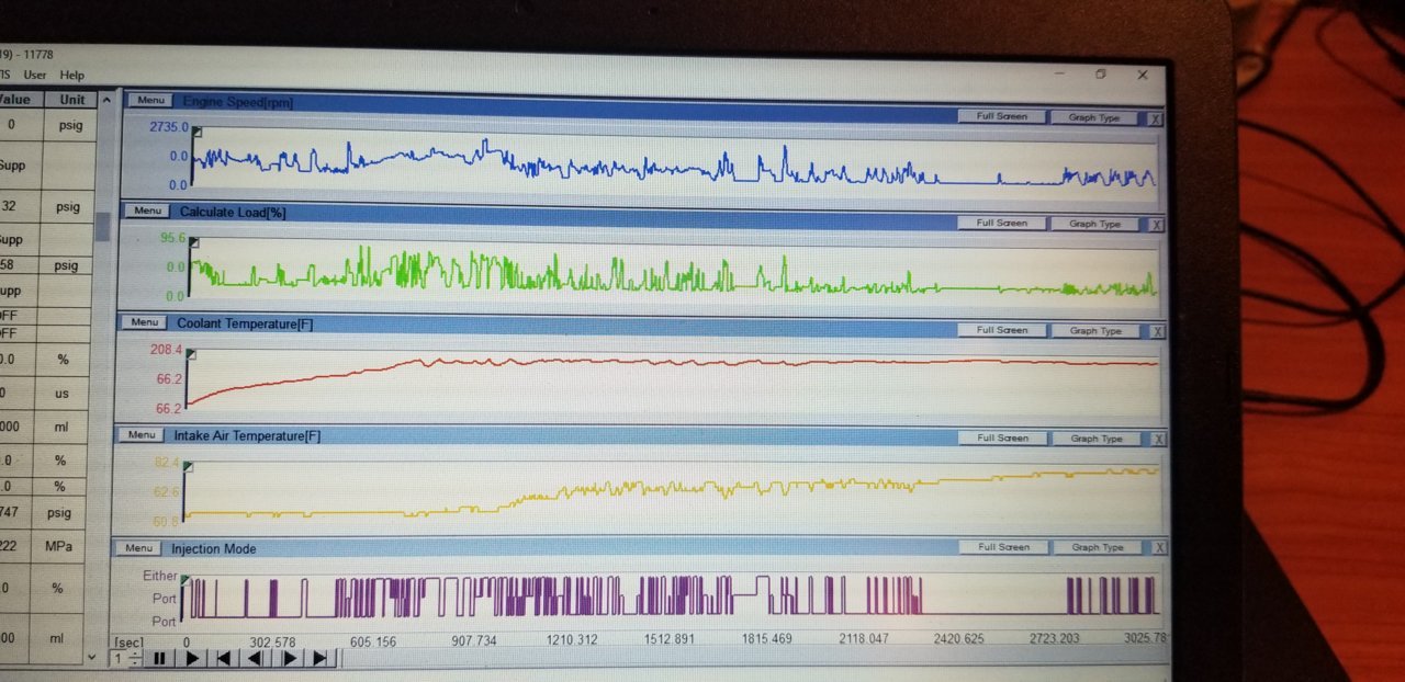

    Here is the stock (tsb) june 2019

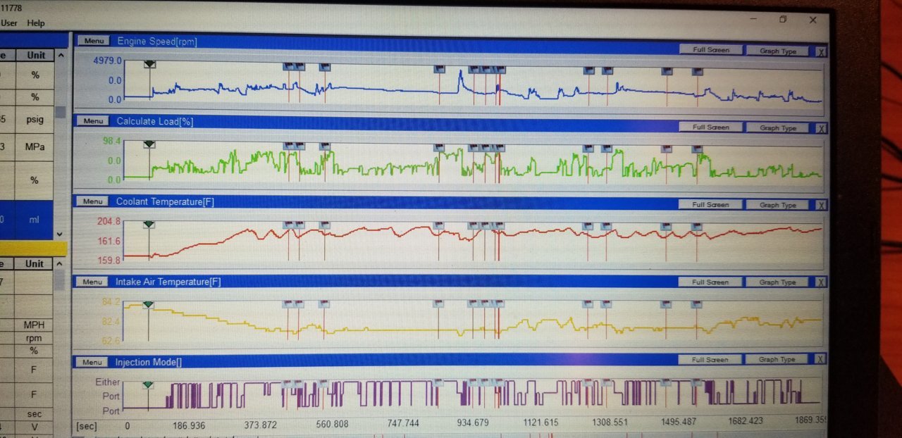

    Here is 1.05 May 2019

    Sure.
    Here is more refined look at the injection mode.
    For total engine run time 2869 sec, injection mode switched to Either mode(assuming either is Port+Di) for whooping 27 sec. (24 at start up, 2nd spike is 1 sec, 3rd -2 sec)
    So my math was spot on, we have full DI injection. Engine ran in Direct Mode 99.06%.
    Just need to figure out if my intake valves got any "gas" on them
    Saiji Satoh likes this.
