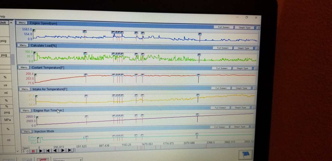

    @OVTune,
    Mat, this is your statement that is not correlating with the data.
    I dont see "some port usage" under your specified conditions.
    See the group of data points in the middle of the graph.
    1.Rpms 1606/load 78
    2.2032/84.7
    3.2011/79.6
    4.2117/81.5
    5.1881/89.4
    6.1464/83.5
    The flag in the far right is the idle, tons of idle.
    Thanks.

    Vlady, I explained it to you exactly how I set it up in the ECU.
    I have already said I will make some changes to it.
    I am not having this discussion any further on this forum. If you would like more information or direct feedback pm me or send a ticket. All of this only ends up going in a bad direction here.
    I still do not see any CSVs from you. It is difficult to interpret the exact data through screenshots.
    If you really want more information then message me appropriately.
    Also, when you log make sure to log ABSOLUTE load, not calculated.

    Right on.
    I did add absolute per your advise.
    So it reads like this now
    5. 1881/89.4/94.1

    I need to see the CSVs and exact break points. It is difficult to see what RPM and exact load point, coolant temps, etc just from screenshots.
    and if you like, in your ticket I will show you how I set the tables, including table screenshots.

    I will do that. Like always
    Will ya fix misfires on cold engine while you looking at? The issue is there since 1.05.
    Or do I need to buy some app and fix myself?
