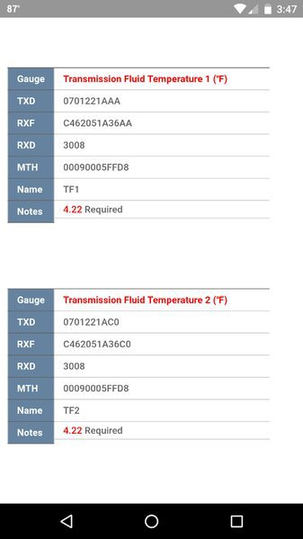

    Do you have a code for the converter status? The one I found from ScanGauge doesn't work.
  13. Apr 24, 2020 at 12:24 PM
    wiljayhi
    wiljayhi “..ain’t nobody’s business if I do…”
    Oct 8, 2018
    #268685
    2,636
    Jim
    Murky Water, MB, eh?
    3G, Tuned
    Trans temps only. TF1 is pan, TF2 is TC
    When the TC is unlocked you’ll know it.
