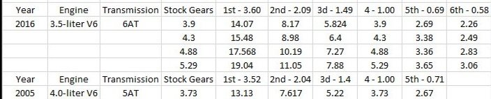

    Why does this truck drive so differently than a 2nd gen?? Is it 100% the engine? The 1-5 stock gearing is basically identical.

    I think it's a bit of the ratio differences between 3rd gen and 2nd gen (see below), and a bit of the EPA logic driven ECU control trying to eek out every last mpg on the standard test circuit... never mind that doesn't work in the real world.
    1: 1.072
    2: 1.073
    3: 1.116
    4: 1.046
    5: 1.007
    6: NA

    I thought OvTune was a complete overwrite of the ECU?

    Even if so.... you can't software the gears. They is what they is. He can change shift points and have various gears hold longer. But you can only bandaid hardware with tuning so much.
