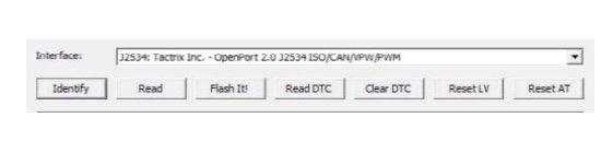

    Out of curiosity, how do you reset the LV and AT? I didn’t notice these steps in the OV videos

    Ignition on, engine off, Reset LV, Reset AT
