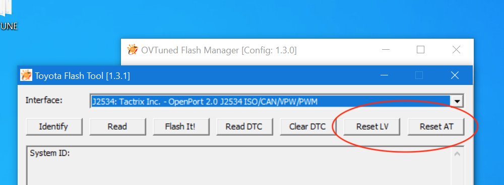

    Dumb question. What does reset lv reset at mean

    Reset the learned values for trims, etc. Reset transmission learned values.

    Learning Value, forgot AT

    Basically just means click these two buttons while doing your flash and connected to the truck. It resets the AT (transmission) and LV (Learned Values) from what I've read. I did mine before flash then did the flash file - could do it after too I'd think as it's not really specified. It gets cleared either way. Makes the truck re-learn and gets rid of any previous issues to make a clean slate so we don't report issues that may not actually exist if it was not cleared.
    Think of it as clearing your browser cache - so everything's a clean slate again and it'll start learning as you go with the new tune.

    Awesome thanks for the photo. Clears things up!
