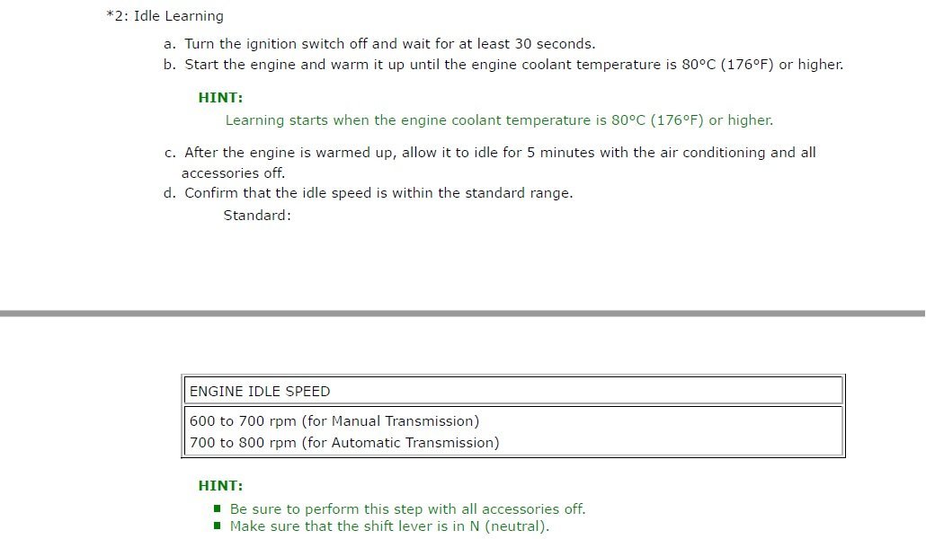

    You can avoid the weirdness of the learned value resets if you flash after your car is warmed up. Idle learning doesn't happen until coolant temp reaches at least 176*. If you start idling from a cold flash, it takes forever for the coolant to reach 176*. So waiting idle 5, 10, 15 mins after flashing when the car is cold does nothing until it reaches 176*.
    Once I did the resets and ensuring coolant was over 176*, the weirdness of the resets went away.

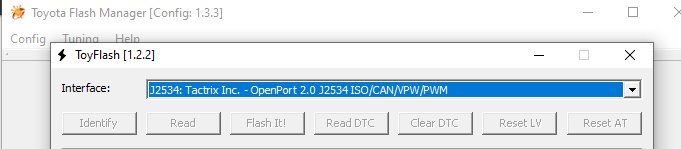

    Hate to be this guy but....
    Been a while since i flashed my truck so i'm going step by step to make sure I do it all right.
    Unable to "identify" my ECU. Stays grayed out... Any tips?
    EDIT: Thinking I need to update flash manager?
