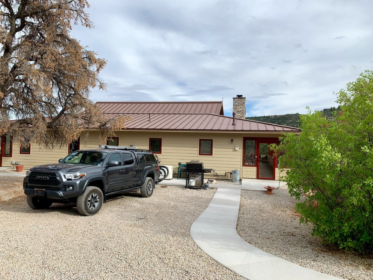

    Update on latest 04B04 2.0F 91 31-33 stock gears. Well over 700 miles on it due to holiday road trip. My start stumble has mostly disappeared, but temps are up and more miles per start. Tune is running great. Hard to judge mileage as we had lots of headwinds and speed limit is high round here (70-80 with traffic moving 85ish). Averaged around 17 mpg on 265/75/R16 C-load with pretty good load. 3 bikes, gear, kids, food, sliders, skids, ARE shell, etc... still happy with the tune, any updates from here is icing on the cake. Looking forward to final release and vF to tweak the few things just for my needs (AGM battery, etc...)

    I’ll be curious to see how it starts tomorrow morning. Temps in the low 50’s tonight. The typical skip I’ve been having hasn’t been there while on my road trip (SLC to Moab/La Sal UT). I definitely have had the start up issues on this and the last 2.0 04B04 tunes released. It just seems to be less consistent lately. Luck or more miles, or ambient temp or...? Jury still out, but definitely driving nice with the latest tune, don’t want to go back to previous tunes, or stock, if I can avoid it.
