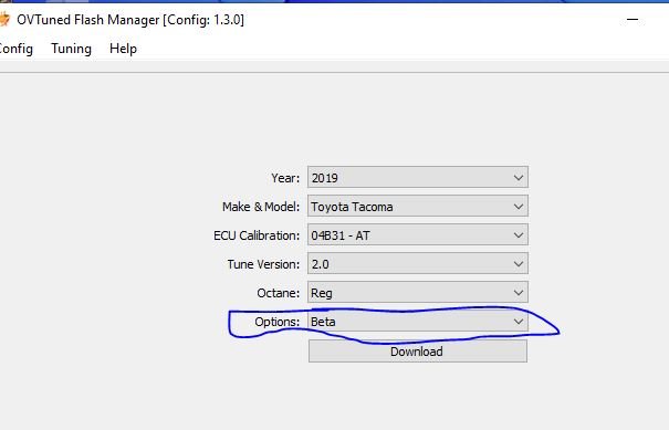

    ok so i'm running the "full version" - what's the difference between that and the beta that's in the works?
    also, where do i get the vft file for the ovtune tunes?

    Thats not true at all. even on the flash manager it list "beta"

    Sorry for the confusion. I'm talking about MTs. @b3itz is MT also.
    Seeing your edit. That is interesting. That last field was not there the last time that I was in FM.

    Only ATs are on Beta at the moment.

    Yeah i don't have the beta dropdown either - so the MT's are on final then?

    MTs have been on 2.0 Full since early March.

    oh god - i just noticed i have both OVTuned Flash Manager and Toyota Flash Manager
    Toyota flash manager has the following drop down options...
    :confused:
    edit: toyota flash manager won't download any tunes

    Toyota Flash was the older version. It was installed in the Program Files \ Toyota Flash folder. OVTuned is the updated version and installed in the Program Files \ OVTuned folder.
    Toyota flash should no longer be working and should have been uninstalled before you updated to the new version.
    Just in case, the Betas have slimmed down versions. They don't contain all the goodies. On my Taco, 2.0 is an animal.
