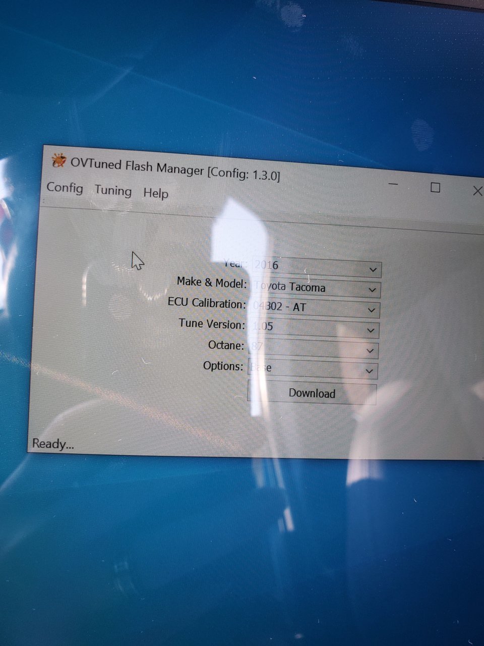

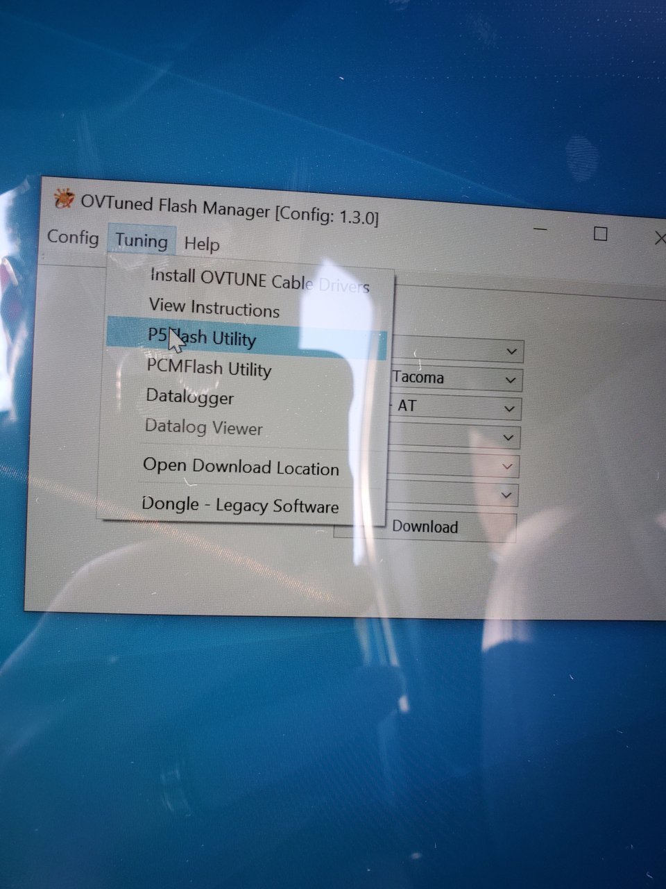

    Hi members. I need help with the software. I can't seem to start P5Flash Utility. Everything I click on it, it does nothing and at the bottom of the screen it just states that it's "Ready". How do I get P5Flash Utility to start so I can install another tune. Any help is much appreciated.

    Click on install ovtune cable drivers and make sure you hit yes instead of no.
    No is selected by default. I made the same mistake

    I've found the instructions quoted below to be very helpful in getting Flash Manager to run properly:

    Thanks for the help. I installed the cable drivers successfully and still no luck.

    Did you update after installing the drivers?

    I had the same issue, still do. What I had to do to get it to run is turn off my norton antivirus. It is full of virus alerts and won't let you run it.

    I’m running McAfee and I turn off real time protection when I run Toyota Flash Manager. Seems that none of these computers like the word “Virus” in the name of the software.

    Try
    Click config > install all software then wait 10 sec
    Then see if p5f utility is available

    It’s more about the signature of the code itself; there’s some copyright protection in there and it ‘smells’ like a virus to the big anti virus softwares since they can’t tell what it actually is/does. It’s been beat to death on this forum with the same outcome: make an exception in your AV software and move forward.
