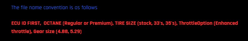

    what is “enhanced throttle” when you get a minute Matt? Is this one tune that’s more aggressive tip in and less aggressive tip in?

    @OVTune - Congratulations and thank you! Three quick questions:
    1) Does "Thx" in the filenames mean "enhanced throttle," and what exactly does that mean?
    2) What does the ECT button do if it no longer switches to a different map in these versions?
    3) Is there a non-gearlock performance map in the works that can be switched to using ECT in a later version?
    Only slight confusion. Otherwise completely stoked!! :headbang:

    Enhanced Throttle:

    Enhanced Throttle = Some throttle changes that makes the throttle more sensitive based on vehicle speed and requested Torque (accelerator, basically).
    Tip in is not modified between the two nor is the low speed range.
    A lot of people wanted to have that performance tune file type of response without the low speed sensitivity.
