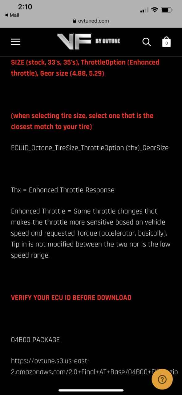

    What is throttle option thx?

    See post, I'll include it on blog.
    Yes it will adjust, but it's much better to use the Regular if you fully intend to just use regular gas.

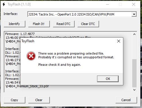

    Ok, what am I missing. First time flashing a p5F after the dongle return.

    Your flash tool is outdated. That is 1.1.0
    We are 1.3.1
    You need any version higher than 1.2.1 to flash.
    Flash Manager > purge local > then Update

    Got it! Flash successful. Thanks so much
