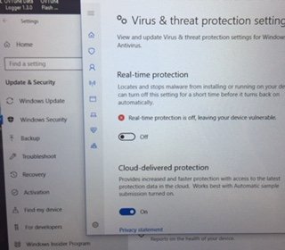

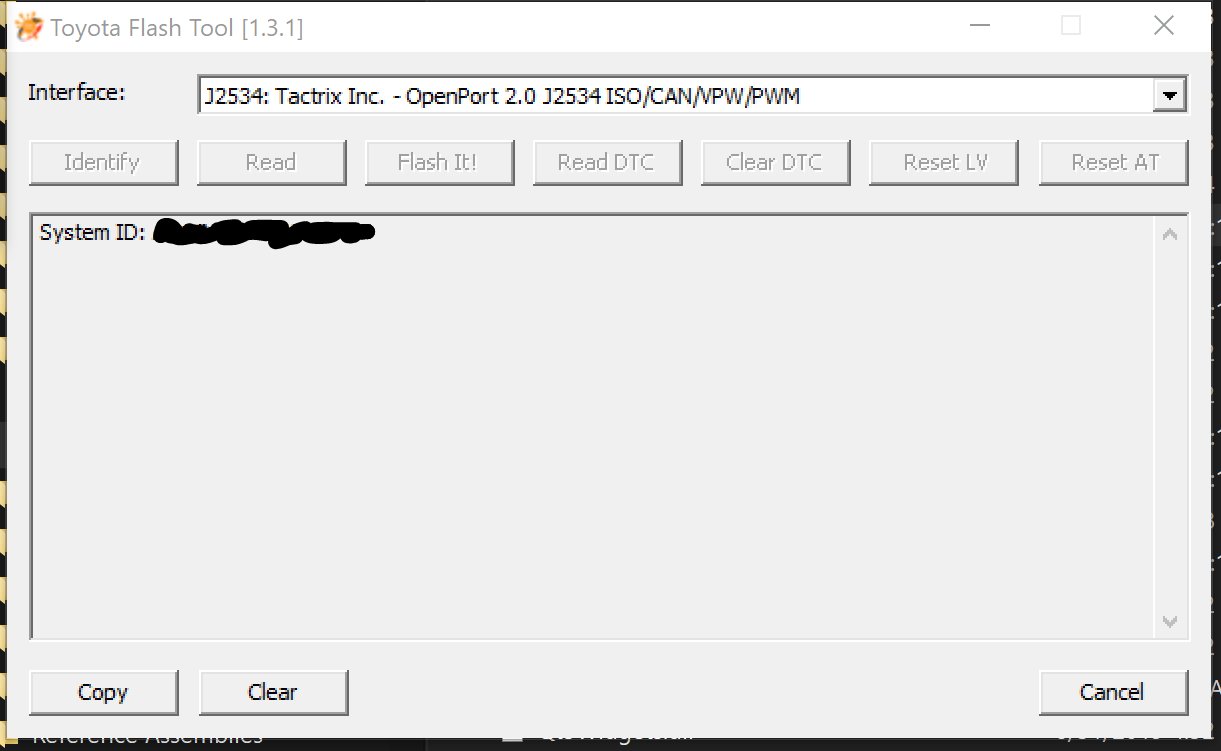

    okay my turn to look like a fool. So i got the latest flash manager 1.3. I went to click on P5Flash Utility and it was grayed out, so i did the Config/Purge Local Data then Install All Software. I went back to P5Flash Utility and clicked it. What should happen next is I get my system ID. But that never happens, instead it just sits there with a little "ready..." note at the bottom. Anyone get this before?

    wow, i thought i had that turned off, but my computer did some kind of auto updated, damn! Anyway, that worked, i didn't have the manage settings and exclusions, but did find the 'real time protection' and shut it off, and now it works, THANKS!
