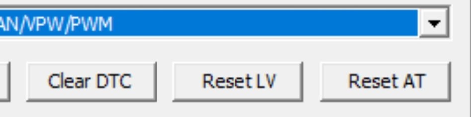

  8. Jun 18, 2020 at 7:04 AM

    2018 TRD OR DCLB
    How do you clear the values?

  10. Jun 18, 2020 at 7:06 AM
    Gjr003
    Gjr003 Well-Known Member
    Feb 16, 2016
    #178387
    398
    i cleared all the values DTC,LV,AT - not sure if that is why, but it worked great. Using the same file as you

    It is on the flash tool
    Skydvrr and tonered like this.

  14. Jun 18, 2020 at 7:24 AM
    Rainoffire
    Rainoffire Well-Known Member
    May 31, 2018
    #255034
    3,104
    2017 QS DCLB TRD Sport
    I think you're only suppose to clear LV and AT, not DTC

  16. Jun 18, 2020 at 7:41 AM
    RustyTacoVT
    RustyTacoVT Well-Known Member
    May 13, 2019
    #293177
    109
    DTC won't matter, it's just wiping the diagnostic trouble codes (if any exist) and resetting the status of the monitors. If you have a check engine light it'll turn it off, that's about it.
