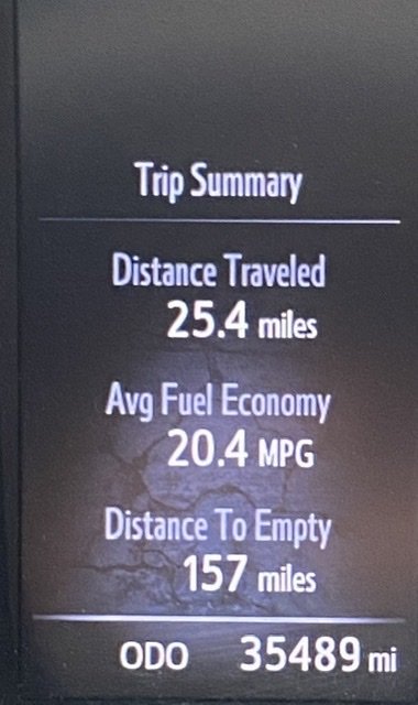

    I have never had fuel economy numbers like this on my commute from work, 2.0 is the real deal!

    On 2.0 SFOB Prem with 87, I was getting about the same MPGs as 1.05 FOB 87, just shy of 19 over three tanks. Swapping to 92 with no other changes, I was at almost 21.
    Give it more time, but if you are running 87, you might want to give high octane a shot?
    Weirdly, 04B14 Stock is shy of 21 also.
