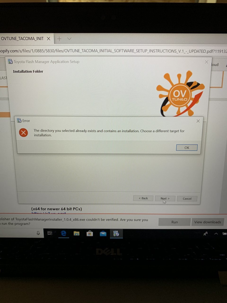

    So I’m trying to download and run flash manager but this pops up
    I thought I deleted everything. Even in the download file it doesn’t show I have it. What gives?
