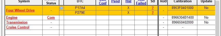

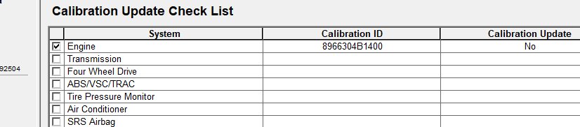

    After you connect you can click "ECU Reprogramming", check "engine", click the green arrow at the bottom right. You will get a window like this:
    Or perform health check (powertrain only) you should see something like this:
    I am 04B14.
