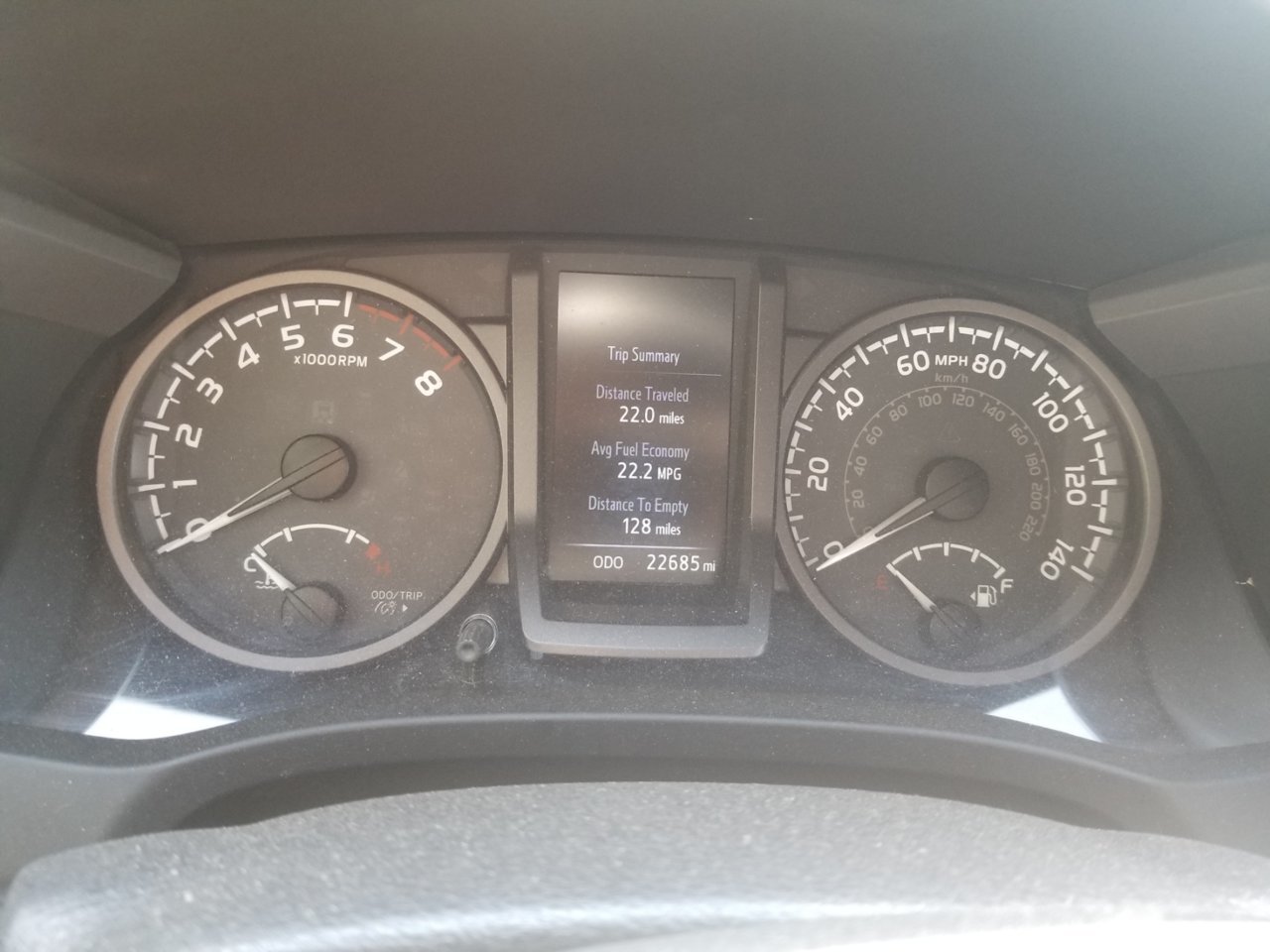

    Thanks ovtune.
    On 255/85r16 with arb bumper, winch, sliders, full skids.
    Edit: It's actually a 25 mile trip by gps, so like 25mpg.

    What version of the Tune?

    04A61/33/prem/thx/stock gears
    About 700 miles on it.

    that aint bad at all considering E rated tires and all that heavy ass weight you got!
