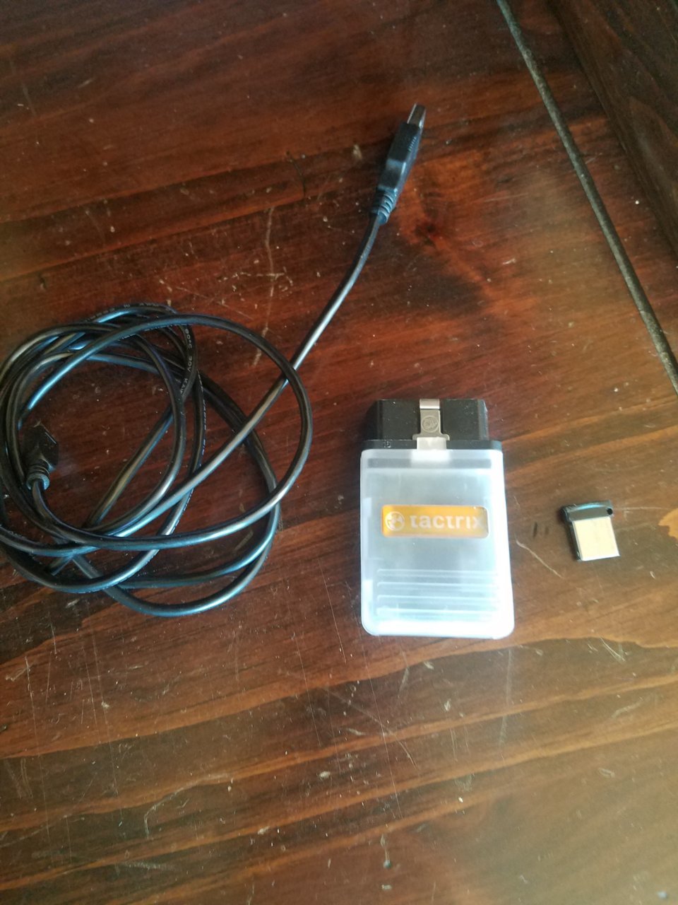

    I apologize for the dumb question, but I’m way out of the loop. I have the dongle version and understand I need to ship it back to ovtune. But I want to confirm if all 3 parts in the picture need to be shipped or do I retain any?

    You just send the USB key (far right). You keep the tactrix and usb cable
