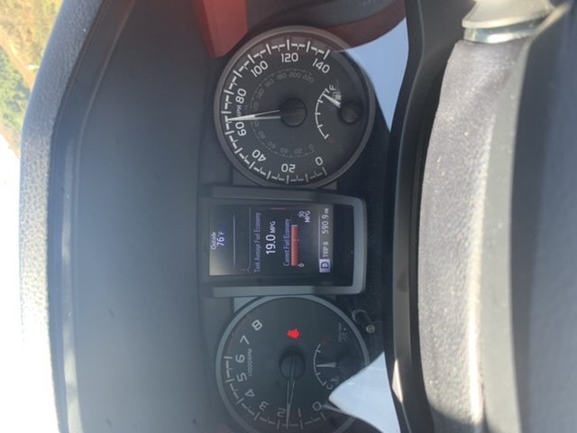

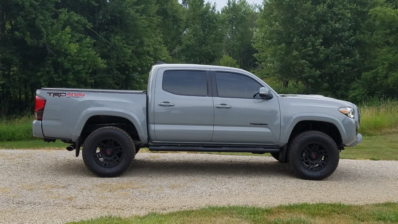

    premium non thx, stock tire size, averaging over 20 mpg's with 265/70/17 tires, and 2" front, 1" rear lift. no added weight other than running boards. Ski

    funny. Cuz I've been running 2.0 base thx premium file and imo my mpg hasn't really changed but the driving is very well improved. Sounds like just a bad day on the tune. Don't see how you jumped up 5mpg. But also 19mpg on the stupid tank average crap with 3/4 tank of fuel doesn't justify it. You telling me you were fueling up every 250 miles? Give or take

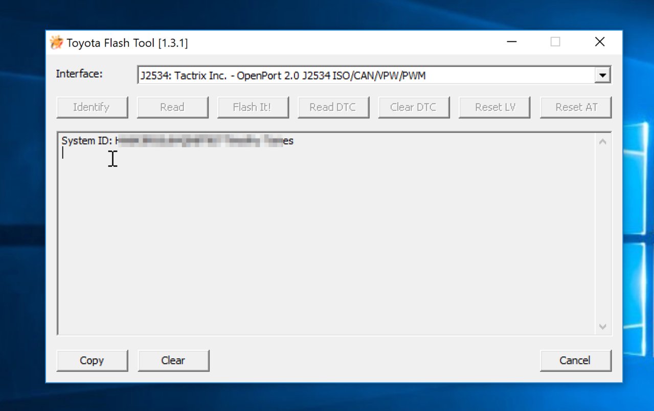

    Okay, so I seem to have all that working. Got it all hooked up and ready to flash and when I opened the P5 utility, all of the buttons were greyed out. See the attached photo. No matter what I did, all of the buttons remained greyed out. Powered off and on. Restarted the system. Re-registered the software. Reinstalled EVERYTHING. Nothing would change it. I made sure everything was connected correctly by opening the data logging utility and it found the vehicle and everything no problem through the OBD2 connection. Any ideas?

    Check the system ID it shows and the one you sent for a reg key. Some windows updates have been causing it to change randomly.

    If the System ID is the name of the reg file, then yes. It's completely different. Guess I have to email and wait for another key then?

    Correct
    same thing happened to @tonered and a couple others recently
