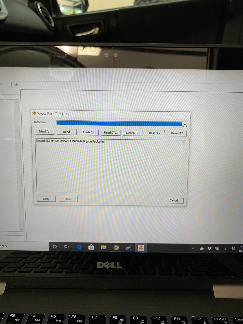

    Have done everything on the directions so far and I’m now stuck. I have the computer hooked up to the OB port on the trucks ECU, and once I hit the flash tool then the screen looks a little different than directions (the highlighted interface) and once I hit identify no calibrations are showing. Anyone have some knowledge to shed? Will be emailing them as well.

    Make sure you installed the drivers, then use the pull down menu under your mouse in your picture to select the tactrix option.

    It's not showing that the Tractrix is present. Is it plugged in to a USB-2 (not 3) port? did you install the drivers?
