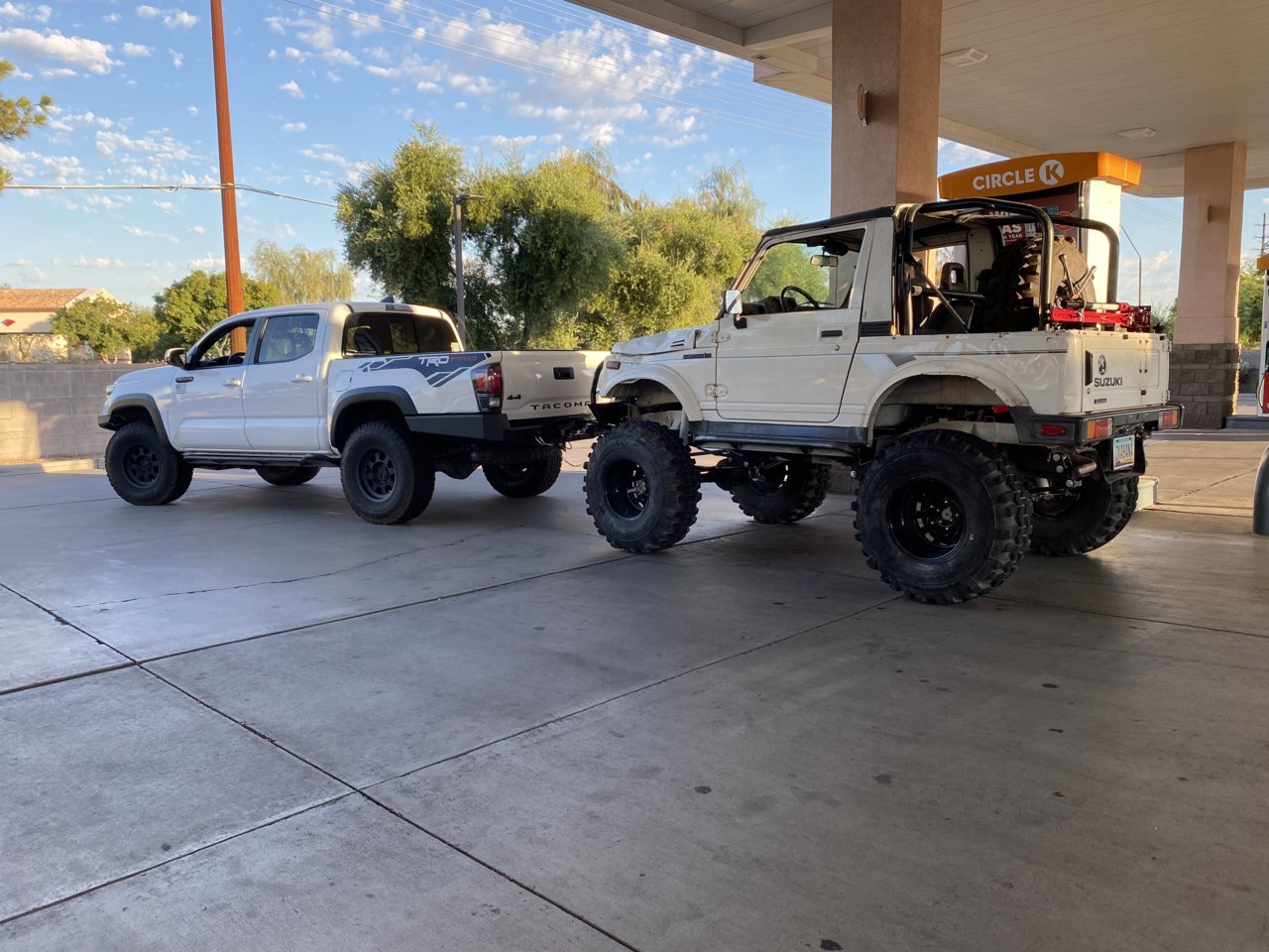

    Gear hunting is the main issue. The Tacoma doesn’t tow great no matter what transmission you have. Sure if you keep it at 55 on mostly flat ground with a light trailer it tows OK. If you live in Arizona and tow at 70mph at elevation on the twisties because the speed limit is 75 it’s not great.
    A manual isn’t going to fix the problem either. The truck is a dog. It’s a NA 3.5L V6 no matter what method of shifting gears you put behind it. I already have 5.29s. They help, but they still don’t make the Tacoma a full size.
    The reason I don’t get a full size is because it is too long to fit in the garage and I like my Tacoma outside of the towing issue which I never even considered when I bought this truck (2nd Taco).
    Here’s what I tow:

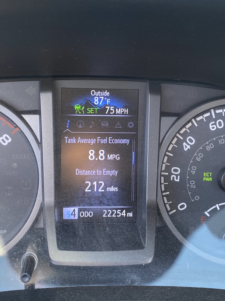

    Here’s what I deal with at 75mph with radar cruise control on flat ground with a tailwind in S5 ECT (this is the current 5.29 tune THX Premium):
    Will I keep the truck until October? Sure. If gearlock isn’t out by then I’ll probably trade it in on a Tundra. I was really hoping to keep it long enough for the next gen Tundra to come out.

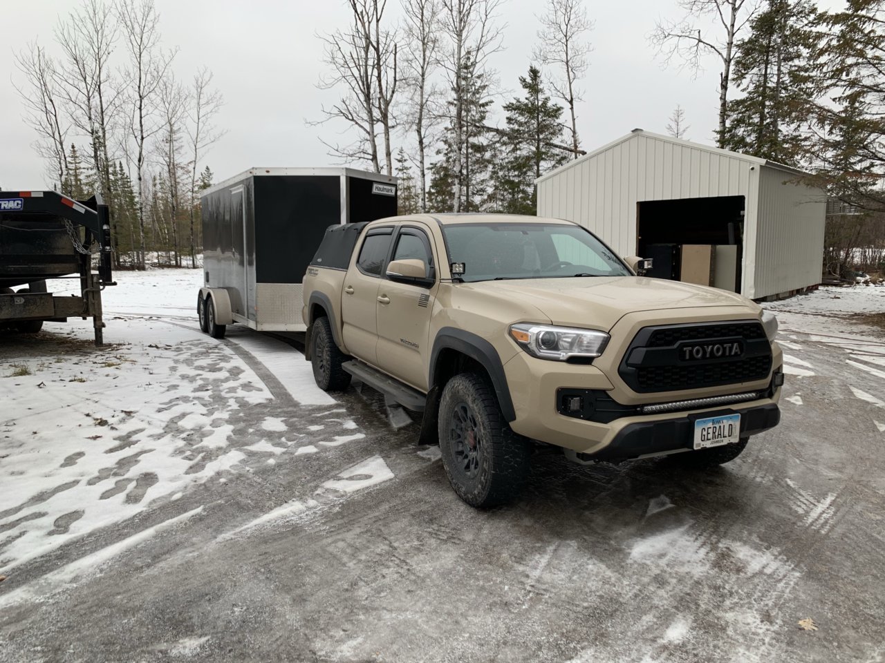

    Is it going to tow like a full size? No but it absolutely can tow. I’ve got 2 different trailers i tow on a regular basis (7x14 cargo trailer and 7x14 utility trailer) and i had a camper trailer for a while too.
    I’ve been across New Mexico, Arizona, Utah, Colorado and others with trailers from 2000-4000 lbs. I’ve never had an issue maintaining speed with my truck. I ran 75 mph from tucumcari to flagstaff on 40 and never left 5th gear.
    I’ll run 2500-3500 rpm depending on speed and terrain. Typically average 12-14mpg. Really my only complaint with the 3.5 is the lack of engine braking.
    the video you posted is exactly what my AT (stock gearing and tires) did when towing. I had to stay 65 mph or less. If i tried 70+ it was all over the place. I think the best i ever got was 10.5 mpg and the worst was around 7 when it was screaming at 4000 rpm
    I’ve not personally towed with the AT with gears or the tune as neither was available prior to trading mine off.
    here’s one of the trailers.

    Ok. I admit that was hard to watch... I tow a travel trailer, but mostly hwy speeds. I too noticed that at interstate speeds she hunts a lot. This weekend will be my first towing experience with OVTune. I can see where your coming from though. When I first got the camper my truck bounced back and forth between 3rd and 4th gear, even at 55-60 mph. I installed a cold air intake and that all but disappeared! No joke. Combined weight of truck and loaded trailer for a weekend of camping is 11,160#. That's asking a lot from a mid size in my opinion. I think it does great for hauling more than 1000 lbs over it's own weight. KN Blackhawk... Give it a try. Just be prepared for a screaming engine when you dig into it! Sounds like a pissed off V8 under the hood when your pedal down above 3500 rpm. Might get you to October a little happier. 20200802_093850-COLLAGE.jpg

    That little drop at 6secs is where I lose momentum and what kills me when towing and I don't have radar cruise control or even use normal cruise when towing. @OVTune had it tuned out in previous tunes but it's back. I believe it's when the TC unlocks.
