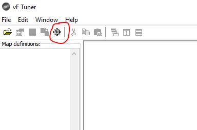

    Without registering your new ECU and with you still having the credits showing in vF Tuner, it seems like you would have an issue getting the tune loaded even with the right .p5f file. If I remember correctly, there are actually/kinda 2 Flash Managers. One with the old deal and one with vF Tuner. The old one uses the .p5f files and you needed the Reg Key that would only run on one computer and I thought only one truck. The new flash manager you access by clicking on the little gear icon in vF Tuner and it uses .vft files. I think you are absolutely legal, I think the process is just confusing enough that you aren't really getting the tune you intend.
    Again... I could be missing a small fact that really means that you are doing things right. When you flash, do you open vF Tuner, click on the gear icon, then in the resulting flash manager flash?

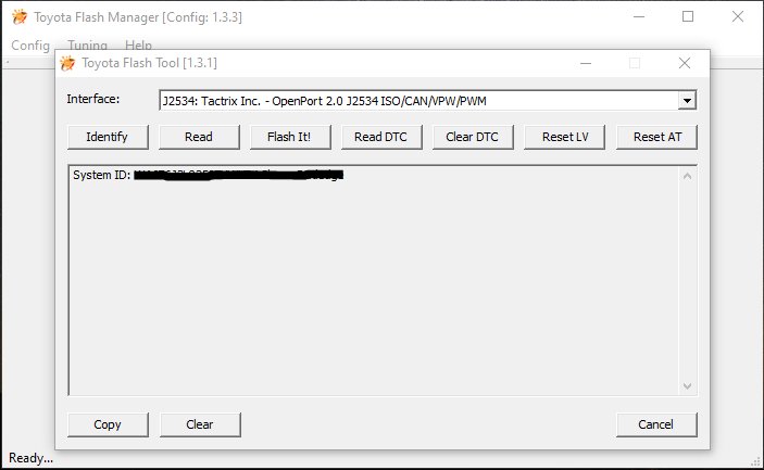

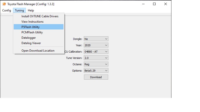

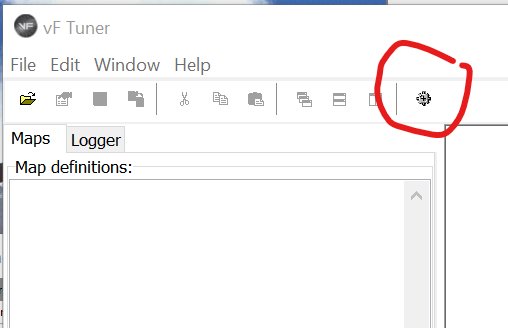

    I appreciate any and all help on this. Hoping someone that has flashed someone else vehicle with their equipment could chime in. I have been following this process:
    • Clicking on the Toyota Flash Manager(1st pic)
    • Then choose "tuning" from the top and "P5Flash Utility" (2nd pic)
    • Screen comes up and I choose "Flash it" and find the file I downloaded from the 2.0 blog (3rd pic)
    4th pic is of the VF Tuner (little different looking then yours), but I don't do anything with that.

    Thanks, I really appreciate the help y'all are providing. I'm not getting any unsuccessful messages from the system. Everything is acting as if it's going through. However, I'm not utilizing VF Tuner at all (even though it's available), I'm using the Toyota Flash Manager as described here:

    I believe the intent of @OVTune was to not let you run through the process they way you are. At one point in time, OVTune didn't want people to be able to flash more than one truck - for obvious reasons. With the advent of the vF Tuner software, that changed. Then as long as you purchased an ECU ID (which you did); you would be able to flash any tune you owned or created on any truck that had the same ECU. In order to do that through vF Tuner though, you also need to own (via Tune Pack or a "friend"), create, or modify a .vft file that was specific to your ECU. You would then use the Flash Manager opened from vF Tuner to put the .vft file on your truck.
