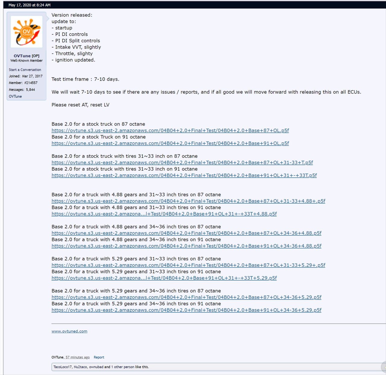

    These are the beta release and 2.0 Final(Test) release pages that I saved. Most are pdf's and one is a jpg.
    FCL30 and WreckedRooster like this.
