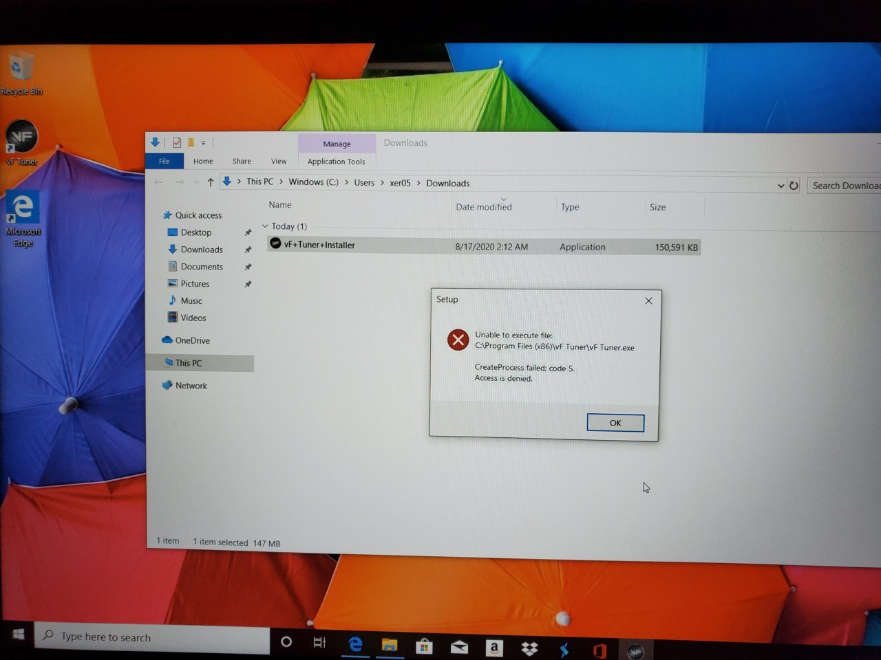

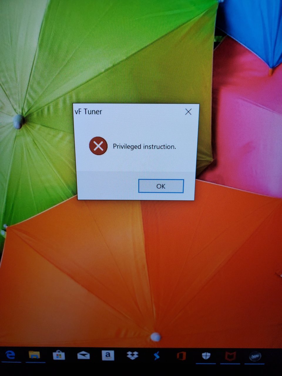

    what do i do after this. doesnt allow me to go further to input after pushing ok. just closes everything out and the even the shortcut is not defunct. im trying to get to the second screenshot posted below.

    this error happens when you don't have sufficient privileges / are not the admin of the computer

    admin? i just opened this laptop just for this product lol. lemme check.

    yeah. same thing. i right click that puppy and run as administrator. came up with the same prompt.

    used method 2 to change my profile to admin. still came up with the same prompt.

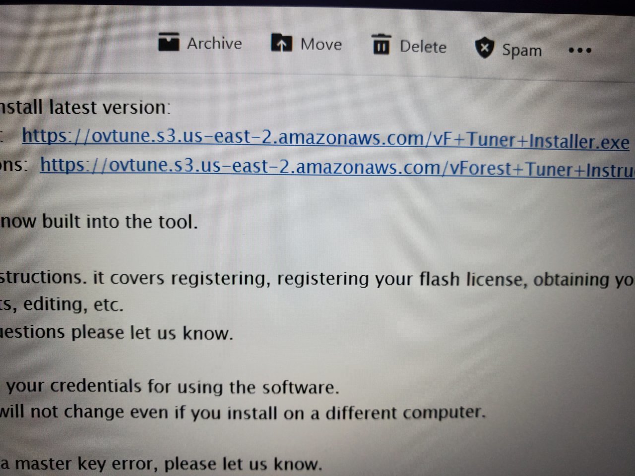

    can someone try that first link and see if it works for them? thats the link i used to download vftuner.

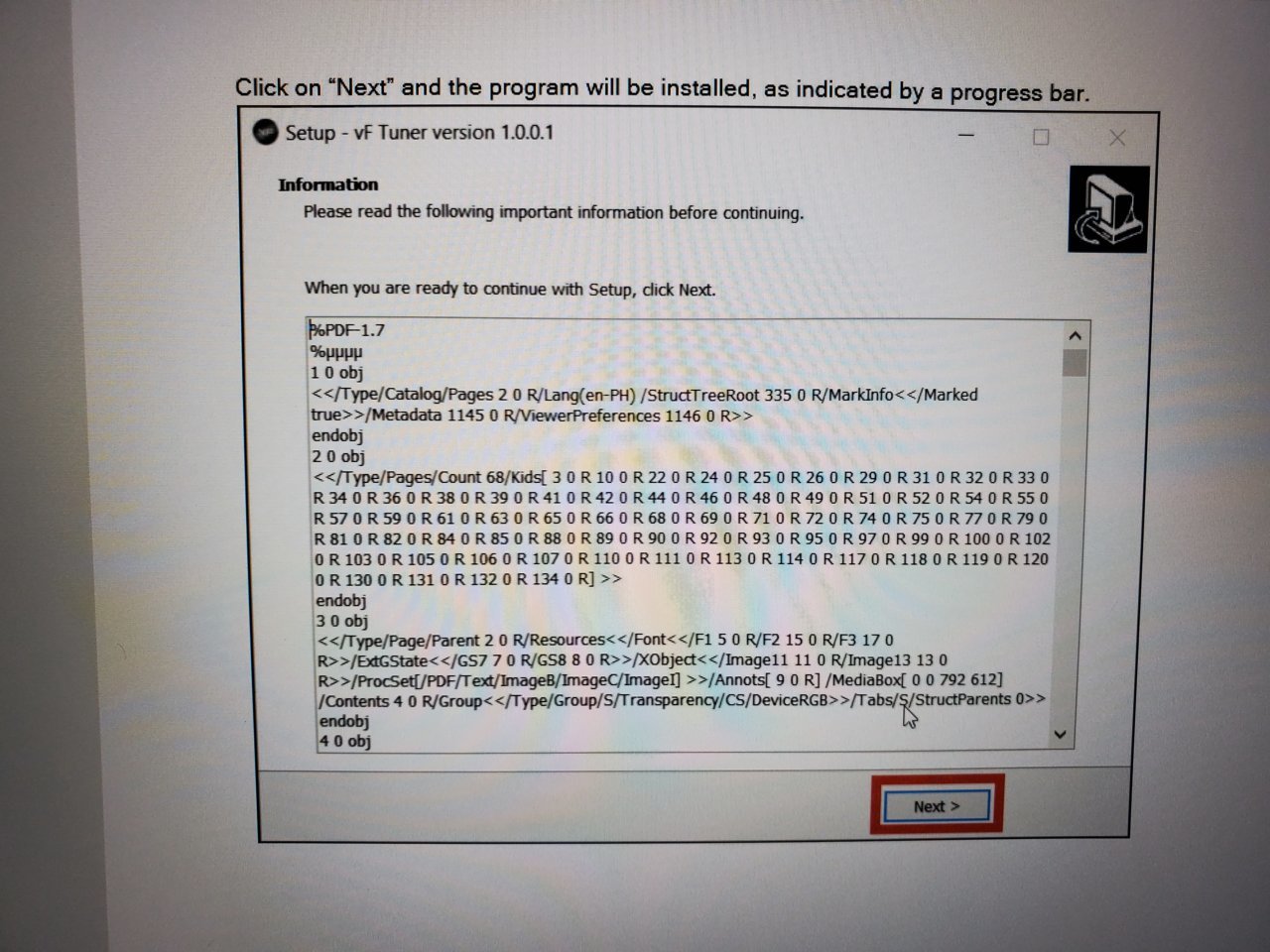

    i noticed during this part, im getting the progress bar as per the instruction, but i never get this screen. everything else is verbatim until that access denied prompt.

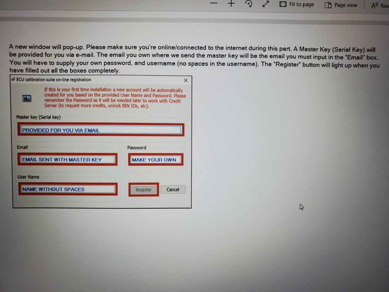

    ok got as far as sending the email out. as far as vf tuner is concerned, do you have to turn off your virus pro every time you use the program or only that initial time because the setup?

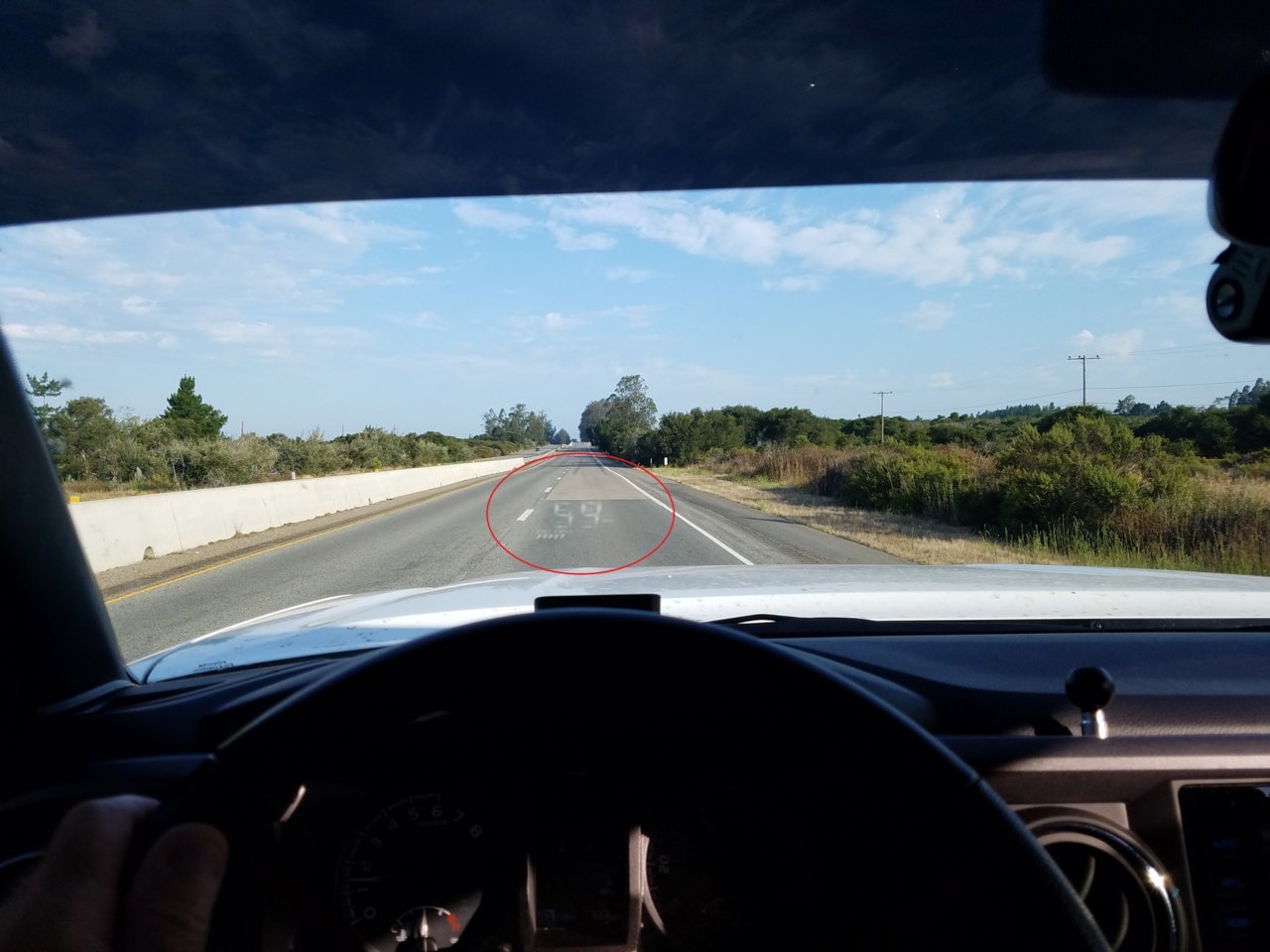

    In my experience using CC, when setting it for 65MPH and hitting an incline, the speed drops to ~63MPH and the truck downshifts to 5th gear.
    Then the truck appears to start increasing speed back toward the set point of 65MPH. But, before reaching the set point, the ECU determines that its still not at the set point and immediately downshifts to 4th gear.
    If the ECU was more patient and waited a few more moments, the truck would have reached its set point and not have to downshift to 4th.
    With that said, not every incline is the same, but I notice the initial drive back to the set point is cut short quite often.
    So, I've quit using CC as often as I have been. My commute is hilly and there are some large stretches of level hwy. Now I use use CC on the level stretches, while my foot and HUD do the rest.HUD.jpg

    It could also be that the throttle was gradually opening more and more while below setpoint until a load threshold was reached that caused the additional downshift. Not sure if the CC parameters are adjustable in vF. Can you log the throttle position to determine what it was doing?

    I’ve also noticed the same behavior with mine using cruise control. Works great on flat or very slight incline. Anything over a slight I just kick it off and I can hold the speed going up the hill without it dropping all the way to 4th.
