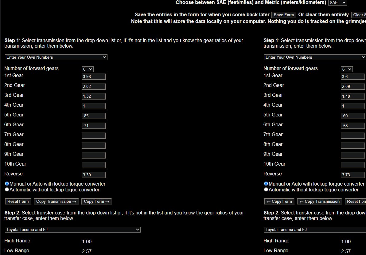

    Here's a great spot to compare gearing:
    http://www.grimmjeeper.com/gears.html
    All the info that you need. MT left, AT right. Hit that save button to set a cookie for the future.
