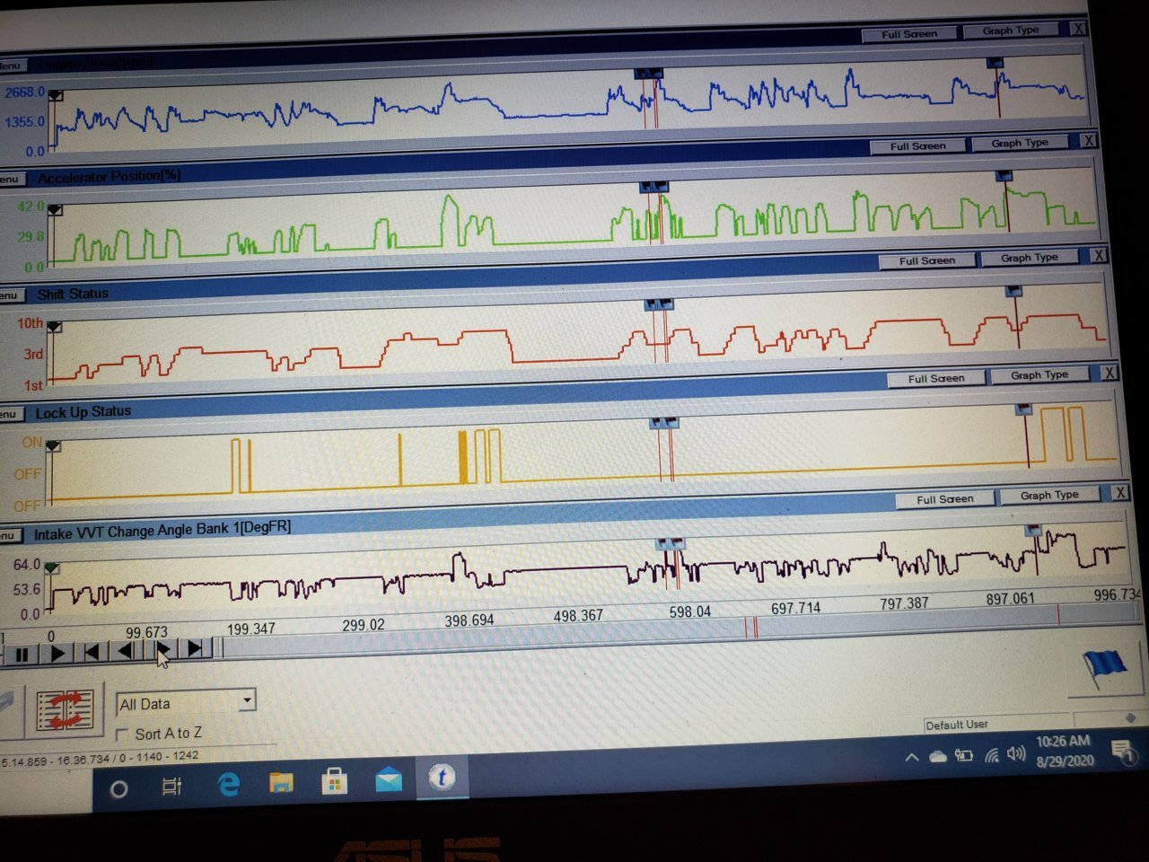

  16. Aug 29, 2020 at 10:31 AM
    Vlady
    Vlady Well-Known Member
    Dec 20, 2017
    #238986
    4,439
    Issy, WA
    2017 White SR5 DCSB V6 4x4
    Don't know, but this is what I see every time I roll to the intersection in 3rd and accelerating out. I drop close to 400 rpms on it.
    See attached. Last vertical line.
    Accelerator is applied and going from 28% to 32%
    Rmps at 1665, intake vvt at 26.
    Then Intake vvt goes to 53° and RPMs drop to 1350, accelerator at 29%.
    Note, 3rd gear, unlocked.
    FCL30 likes this.

  19. Aug 29, 2020 at 12:07 PM
    dunlap837
    dunlap837 Well-Known Member
    Apr 8, 2020
    #324170
    464
    2018QSDCLBSR5
    Enhanced Skinny Pedal
    Is the rpm dip short enough that it is obscured a bit by the line? It is tough to tell with the low resolution screenshot.
    Also what is going on with vehicle speed there. Assume you would have to feel it jerk a bit, right?
  20. Aug 29, 2020 at 1:36 PM
    Vlady
    Dec 20, 2017
    #238986
    4,439
    Issy, WA
    If you step through frame by frame it goes like this driving in 3rd.
    Rpms 1665 1723 1355 1479 1629. 1782
    Accel. 28. 28. 30. 33. 32. 30
    Int. VVT. 27. 27 54. 57. 58. 41
    Thr.Pos. 17. 18. 19 28. 19. 18
    Load. 59 60. 72. 77. 74. 65.
    Speed. 13. 16. 18. 19. 22. 24
