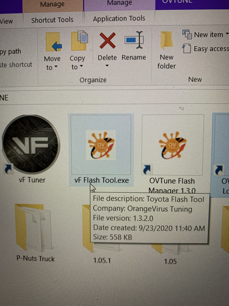

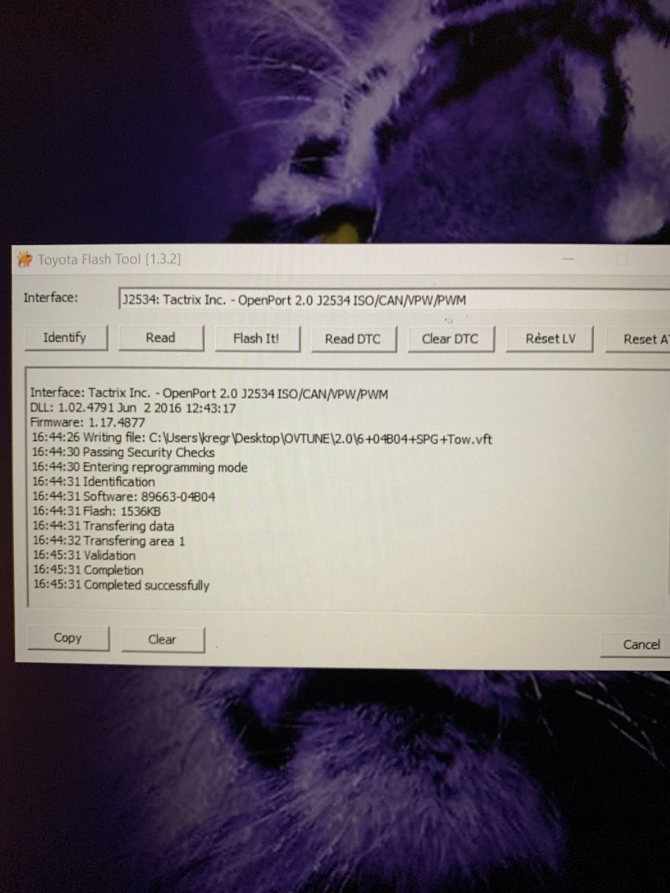

    Gotcha @Shellshock. Here’s pics @YotalovesTaco

    To flash vF files, you need to install vf tuner and use the flashing utility bundled with it.
