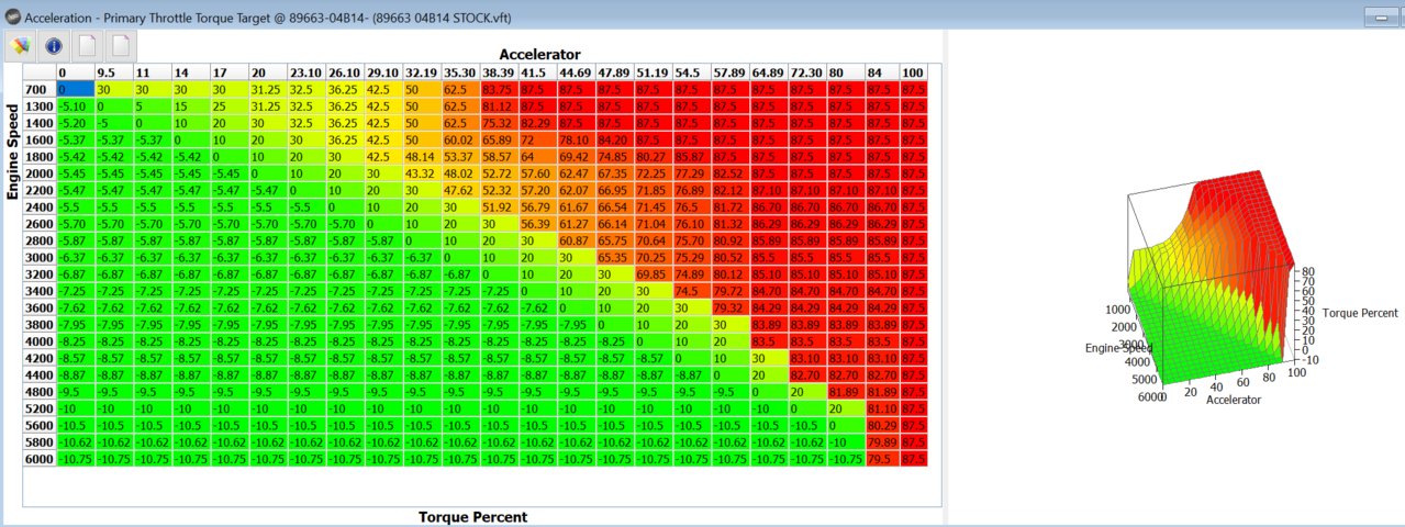

    This just seems to be the way the accelerator is programmed. I'm trying to wait for the final GL/perf/etc. tune before I dig into vF to fix it; but, it sure seems to act just like this chart looks (from an MT).
    If the AT tune is anything like this (and it feels like it is)... depending on rpm, only ~3% more accelerator can give you over double the torque! Drives me crazy.

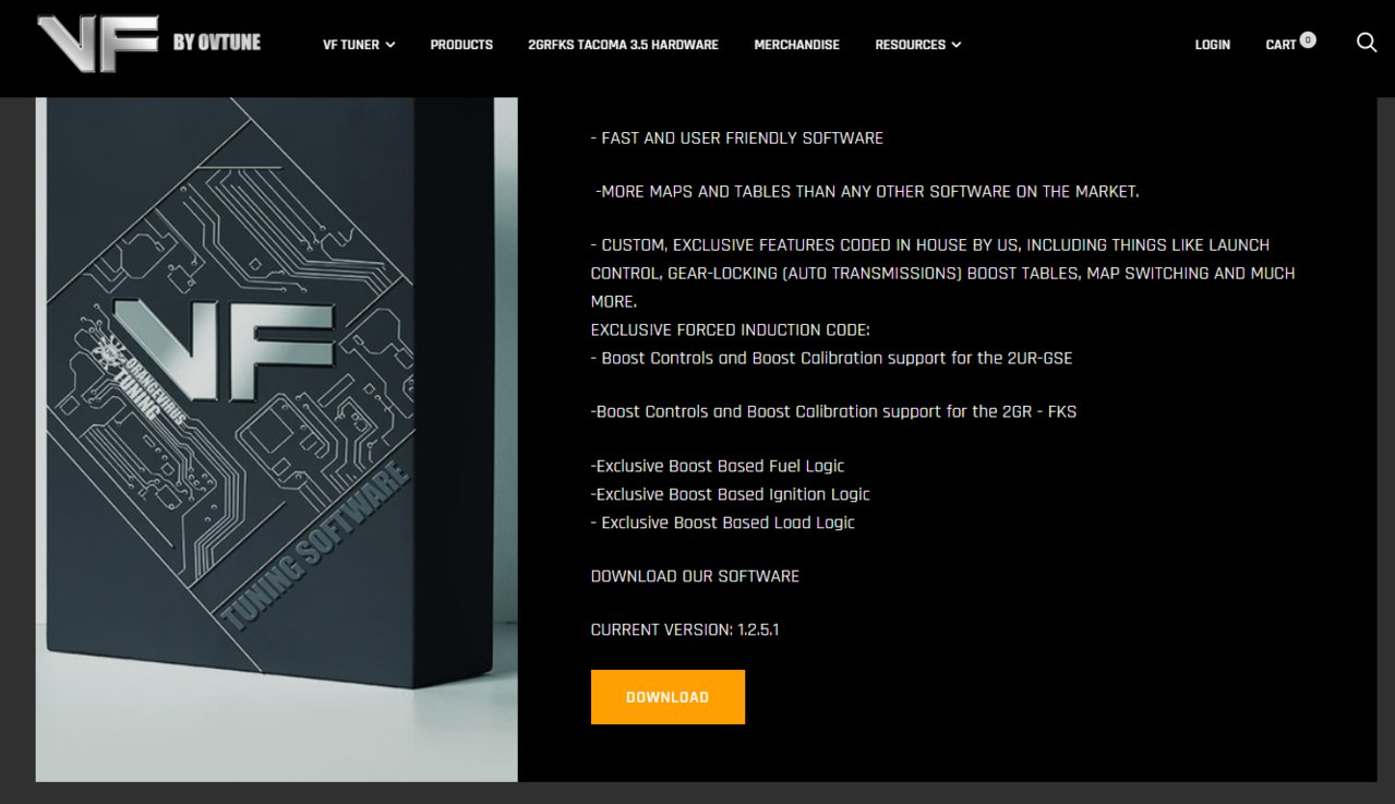

    You need 1) VFTuner & an OBDII cable:
    https://www.ovtuned.com/collections/vf/products/vforest-tuner-software-flash-cable
    You need 2) tunes... (Tacoma that is). You can get something from someone on here that has baked their own, or this from OVTune:
    https://www.ovtuned.com/collections/vf/products/tacoma-3-5l-vf-tune-pack
    Variations on this are you can get your own tactrix cable from them if you want (and order OVTune's kit without the cable), or wait for OVTune to have their wifi OBDII back in stock.
    https://www.ovtuned.com/collections/vf/products/vf-tuner-wi-flash-cable
    Personally, I'd pony up the extra $390 just to get the direct source files from OVTune. This way, any future updates he makes to those you're likely to get as well. Having said that, others on here are willing to share their edited tunes which started from OVTune's work as the base. It's your call on if you're comfortable using someone else's tune.
    <edit> PS, you'll need a windows laptop, or a Mac running Bootcamp or Parallels.

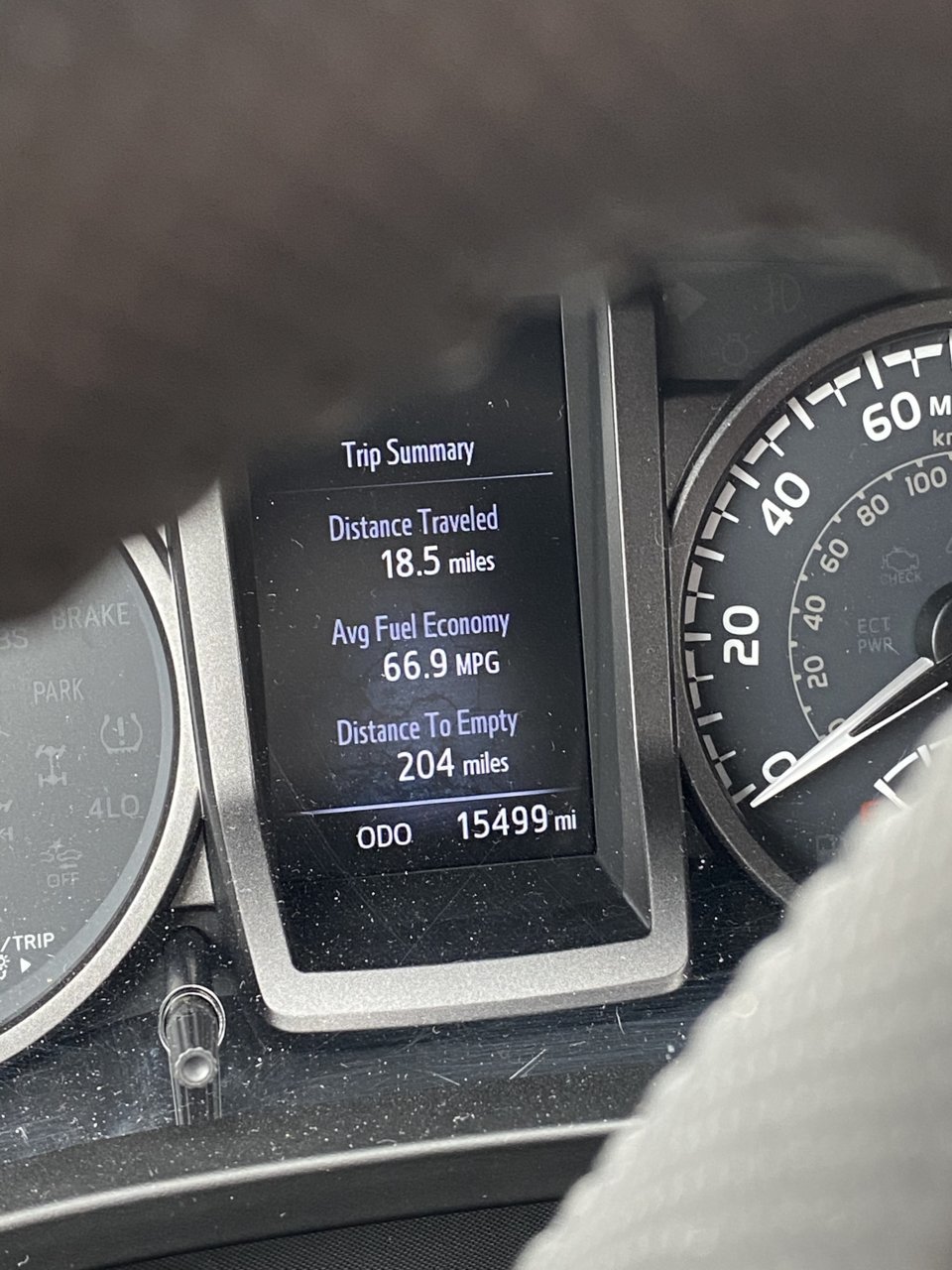

  13. Sep 28, 2020 at 7:26 AM
    Karminski
    Karminski Well-Known Member
    Sep 28, 2018
    #267676
    427
    Virginia
    2016 Tacoma D/C M/T TRD Off-Road
    :eek:
  14. Sep 28, 2020 at 9:02 AM
    ihatemytruck
    ihatemytruck Smartass
    Jul 26, 2013
    #109078
    1,636
    Dave
    Southern California
    '17 Tacoma 4x4 off road DCLB
    Mostly downhill? :rofl:
  15. Sep 28, 2020 at 9:32 AM
    buckyop
    buckyop Well-Known Member
    Oct 25, 2018
    #270585
    125
    2018 Tacoma off-road xp Black maverick edition
    Of course
    ihatemytruck[QUOTED] likes this.
  16. Sep 28, 2020 at 9:51 AM
    ihatemytruck
    Jul 26, 2013
    #109078
    1,636
    Dave
    Southern California
    I have a picture somewhere of a 99.9 mpg
    buckyop[QUOTED] likes this.
