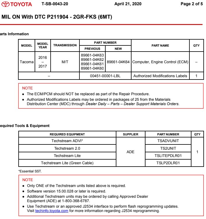

    I'm guessing that 04C20 is MT and 04C00 is AT?
    And old OVT quote:
    It's up to you about what you want to do, but . . .

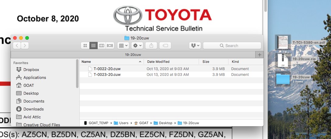

    @Saeros Just downloaded the CUW zip file, and wondering if you can tell me which one is for the 04B81 update from 04B80
    thanks bud :thumbsup:

    HA a quick google search led me to Tonered's thread telling me 0023-20 is what i want!
    tonered[QUOTED] likes this.

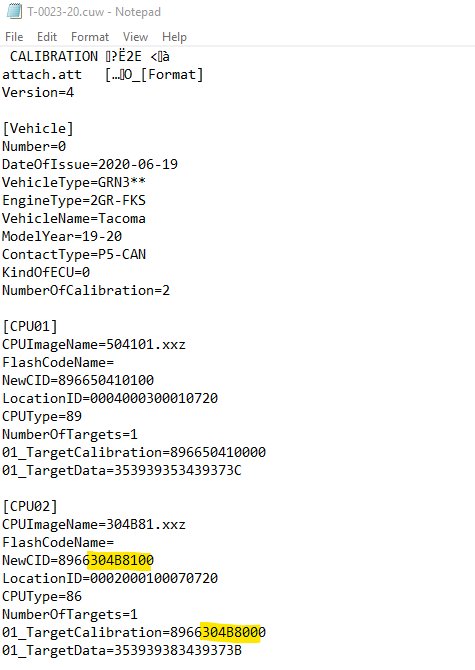

    BTW, all CUW files can be opened in a text editor like NotePad. The header info will give you a lot of that info:
    Beyond that, the TSB updates are somewhat foolproof. It will not flash a CUW that is not applicable to your Taco because of that header info.

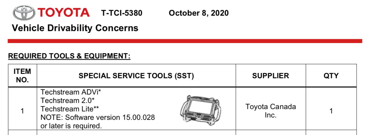

    The version of Techstream i have is the one you have supplied a link to v14.20.019. Should I be at all worried the Service Memo states I need v15.00.028?

    That was on TSB-0043-20 for 04B14 also. I had no issues. In fact to flash CUWs, you don't even need a fully functional version of TS as the CUW is an executable. We were able to flash 2018s with V12 even though it would not connect to those or newer Tacos.
