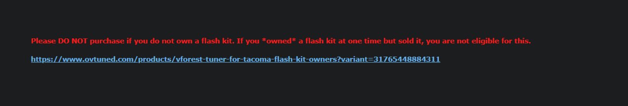

    i guess i need to download vftune. i was on the site, i cant find where the free download is. ill probably spend the 80 and open it up (if us previous tune people can still do that)

    Thanks. I’ll try to figure this stuff out tonight or over the next couple weeks while off work. Haven’t requested a tune pack yet so I’ll flash the tsb and request the new tune pack.
