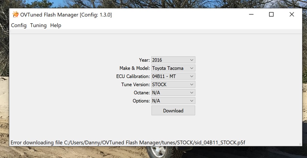

    Sorry this may be off topic here or covered already, but i can't seem to find an answer, Flash manager/2.0 did not become obsolete did it? I can't seem to download files anymore, i keep getting this error, can anyone point me in the right direction?

    They’re no longer downloadable from flash manager. Everything is being ported to vftuner now.
