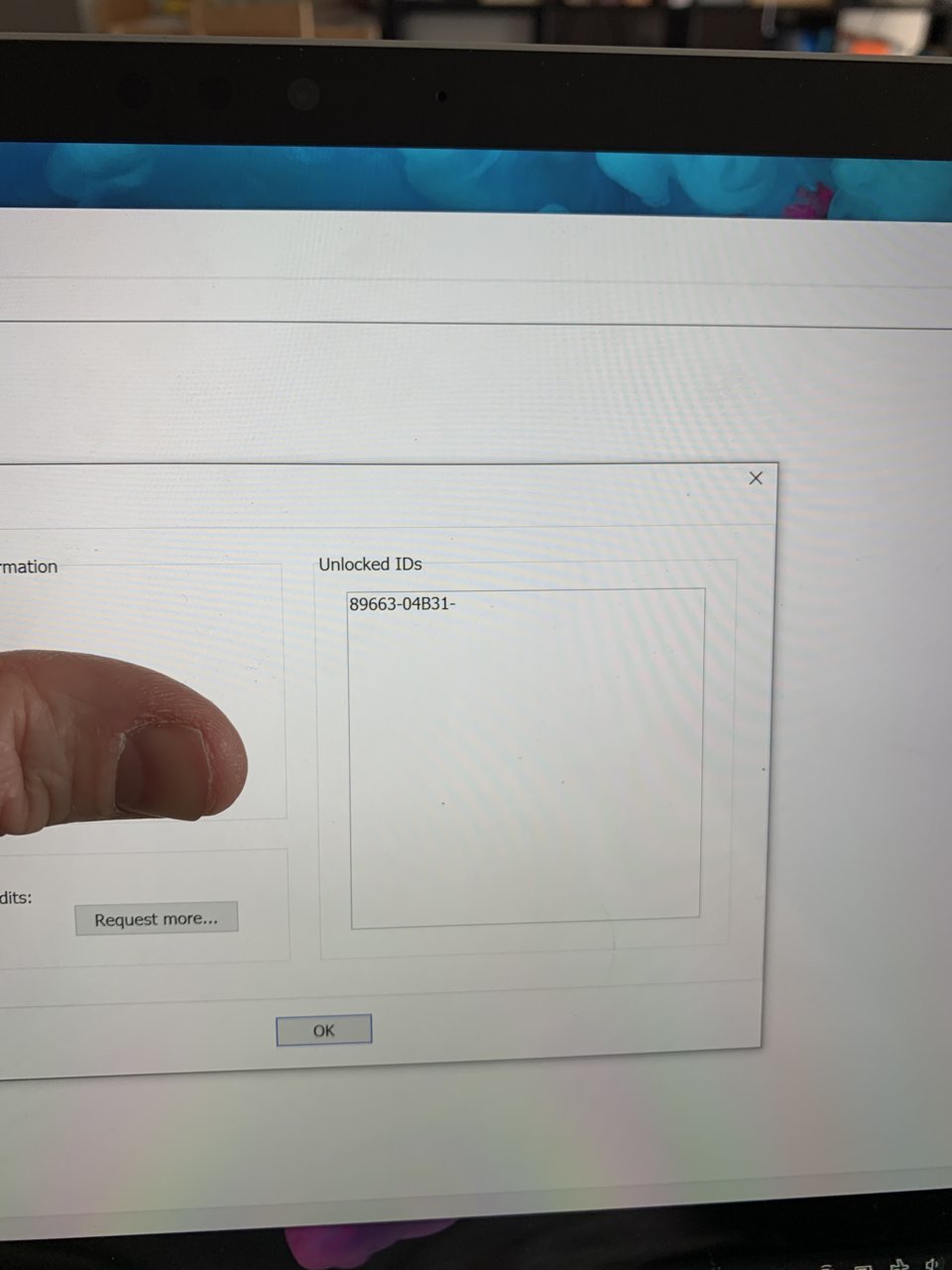

    So I upgraded from the original tune kit to the VFtuner. I registered everything and downloaded the the v2.0 Final VFT file for my ecu but I can’t put any into the VFtuner to edits them. I keep hearing you need to wit for the tune pack. Isn’t the v2.0 Final VFT file the tune pack or am I missing something?
  9. Jan 29, 2021 at 7:28 AM
    Shellshock
    Nov 21, 2015
    #170338
    23,410
    Iowa
    The zipped folder of vft files is the tune pack (you get a download link from zendesk). You’ll need to unzip the folder and then you can open the files in vF tuner.

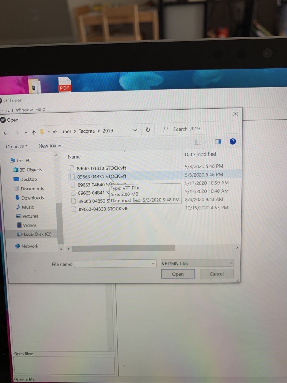

    In vf tuner, you just go in the upper left and open a file, then browse to the one you want to open. The first time opening a ECU, it’ll ask if you want to use your credits. It costs 4 credits per ECU (04b04 for example) and you can open any files for that ECU.

    ok so I have my ecu unlocked.

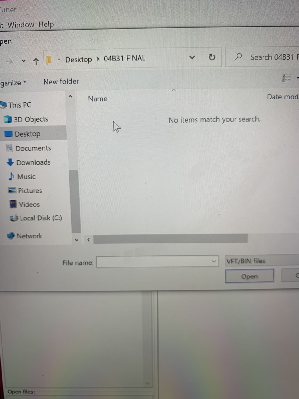

    When I go to the tune pack folder is says there are no files in the folder but when I open the tune pack folder up from outside the VF tuner program I can see all of them.
    The only one I can see is the stock tune that was in VFTuner.

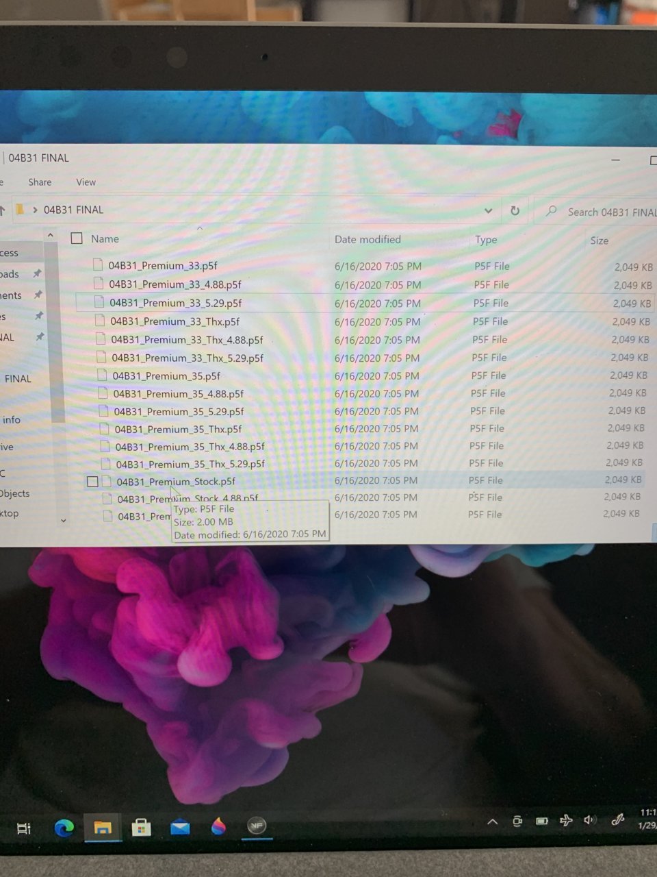

    You have P5F files. Those won't open in VFT. Only .vft or .bin files can be opened in vF.

    As I said, you must request a TP from OVT for the ECU ID that you want.
    You can flash those P5F files to your Taco, but you cannot edit them.

    I figured it out I was under the wing folder. Thanks for your time.

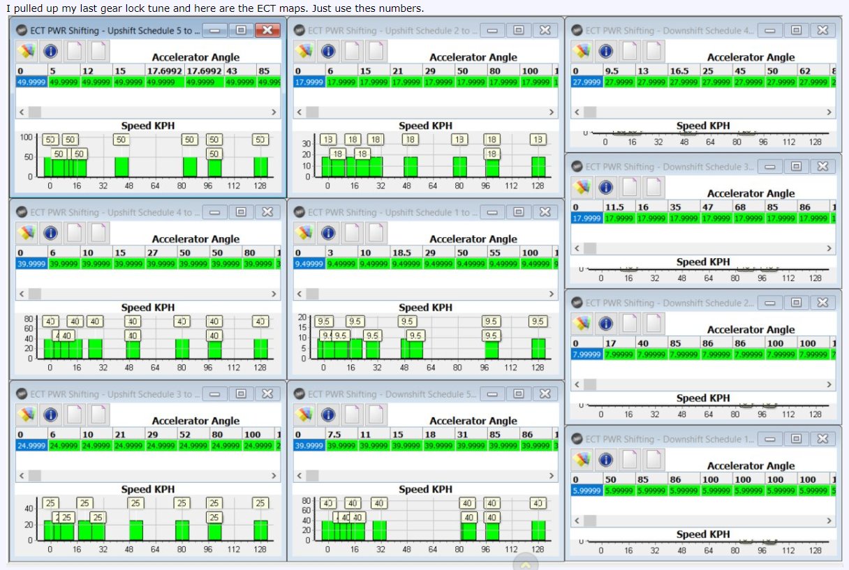

    I screenshotted one of my posts from a while back for gear-lock. I personally do not use gear-lock.
    You basically use the lowest number in all the ECT shifting for each map. Then gear lock is S mode+ECT. You lose your ECT.
