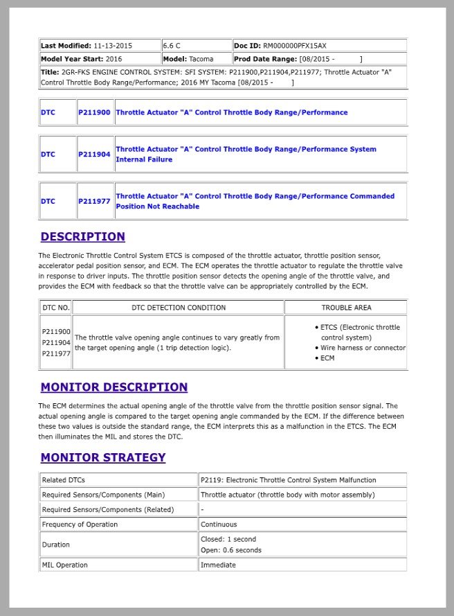

    Exact code. First upload of tune A threw me into limp mode pulling into cross traffic. Almost shit myself:( haha

    Yeah and if you read what limp mode actually does - wow. The ECM cuts drive current to the throttle valve motor, so what you get is 7deg of opening (it's held that way by the spring). The ECM then controls engine O/P with ignition timing and intermittent fuel cut. Man, it's like you pulled 5 of 6 plug wires and tried to drive.
