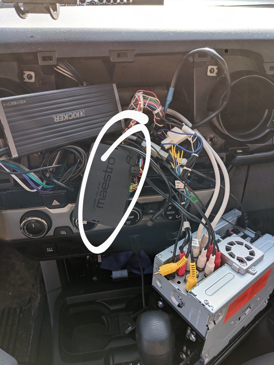

    Ok, it was not the radio but I did get it to work. After you mentioned the radio, I remembered that I also installed a maestro data link. I disconnected that and that did the trick. PXL_20210327_220437195~2.jpg

    You should be able to disable maestro odb2 communication from the headunit. I’ve gotta do that on my kenwood
