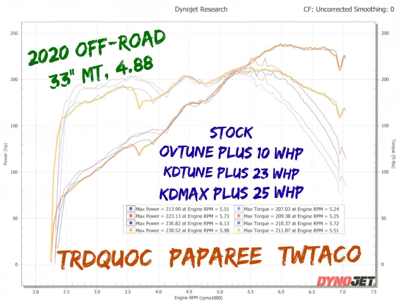

    I look forward to the next dyno results.
    Beyond that though, there's the seat of your pants grunt that you get with SFOB at RPMs well below what will be run on the dyno.
    You can be running in 6th at 1100 RPM on back roads, happy as a clam. The truck will hold it's own, and accelerate up slight inclines if you need it to.
    Then there's the short shift into 2nd. You can again be at 1100 or lower and the truck will pick it up and get along nicely. Same with 3rd.
    It's a hard thing to compare, but when it's not there, you know it.
