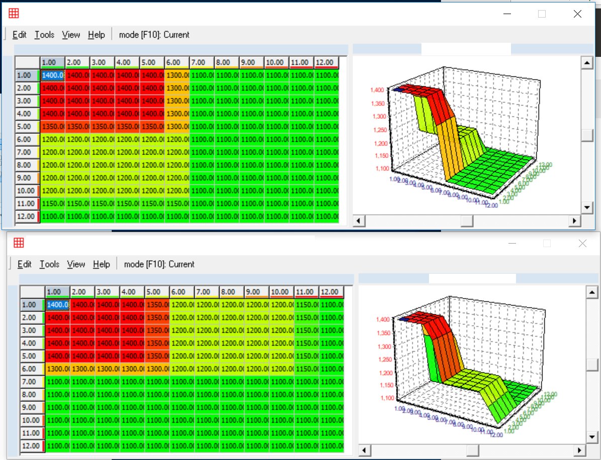

    one is related to idle,

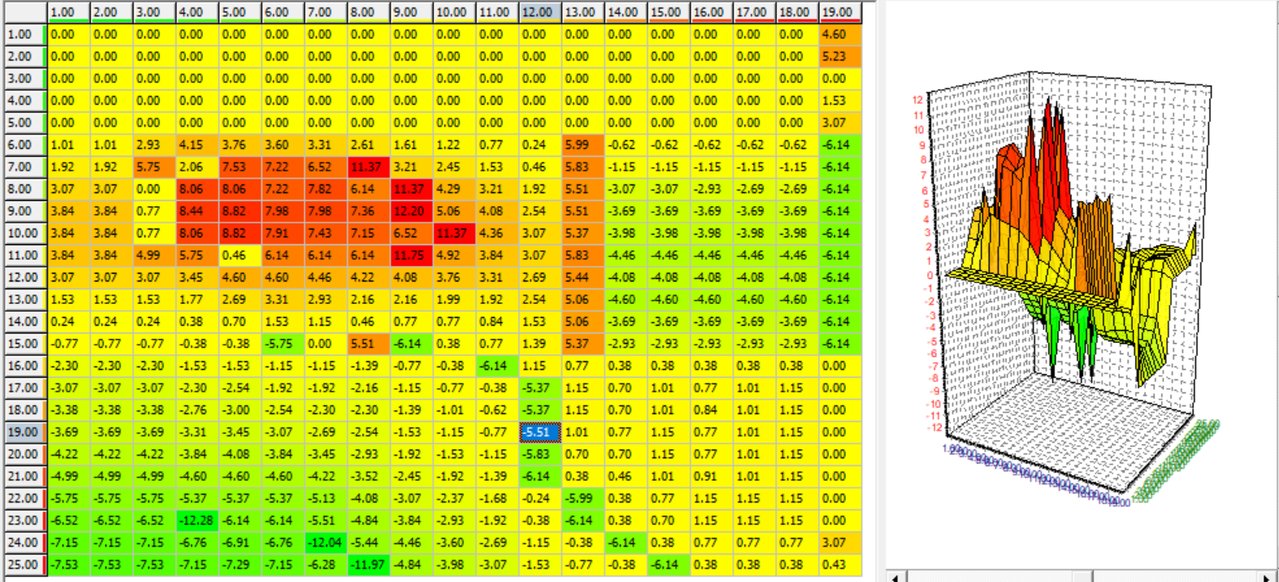

    the ugly one is a nice ignition compensation map for Atkinson mode / valve retard.
    Our update to the ignition logic will really change things. We're changing the structure of how the ECU calculates it's final ignition value.
