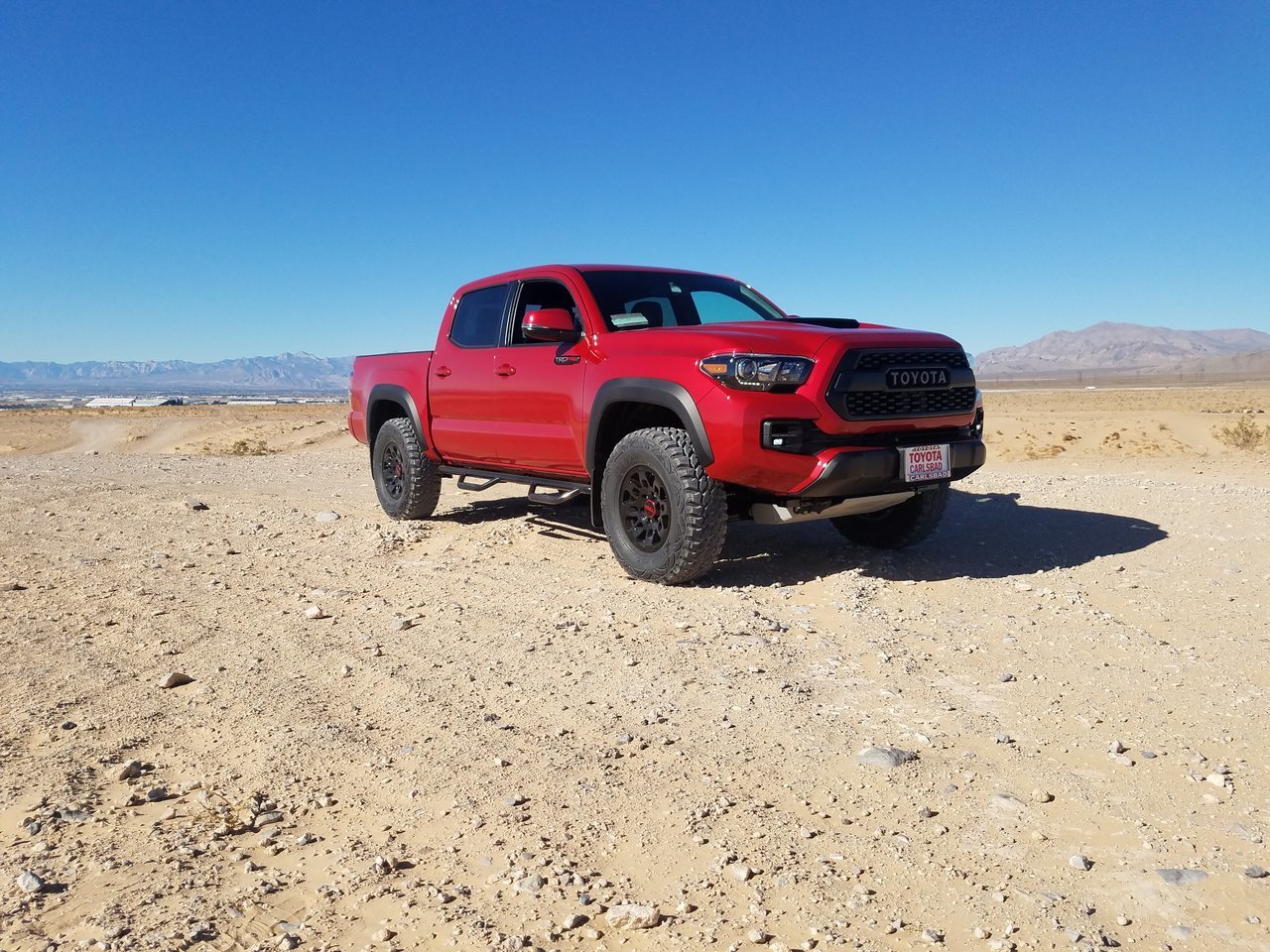

    Okay Folks..
    Put 700 ish miles on the truck over the weekend. Kept it on 100% stock tune.
    Tested off road, 4H, 4L, Crawl, etc
    The Initial
    The Truck is very easy to drive off road. Very nimble.
    To me, 4 high feels ok
    To me, 4-Low feels power / throttle restricted
    Crawl Control is very easy to use, because you don't have to do anything. Truck drives itself.
    The Bad
    about 400 miles in..
    Truck cannot or will not leave 6th gear.
    When it decides to get out of 6th, it gets stuck in 4th. Cruising at 75mph in 4th.
    5th gear is a mystery gear that pops up once in a blue moon
    6th gear with half / moderate throttle = ZERO acceleration.
    Worlds most annoying idle bounce when A/C is on, will rev up to 1k, drop to 500, up to 1k, drop to 500,
    Truck will downshift 4th, speed up, shift 6th, cannot accelerate, lose speed, downshift to 4th, for infinity.
    Tested highway MPG: 16-17
    So I see where all the complaints came from. Next step is run my 1.02C map and develop further. Already see several things I want to change.

    Are the steps ugly? They came with the truck. Dealer would not accept removing them and crediting the cost as part of negotiations haha.
    Stock S mode is so useless. it will be a big focus for improvement.
    I ran out the 87 that it came with, and then 91 the rest on stock tune.
    One thing I notice but nothing the logs show to pin point is that the power feels very "surgy." Not sure how to explain it but the truck feels like the power comes in waves
    during some off road testing I tested in 2WD and 4H and the truck just feels so natural in 4H (flat ground dirt road)
    Something I want to fix asap is the truck shakes at idle.
    The hood is the best part
    There is still much to be improved :)
