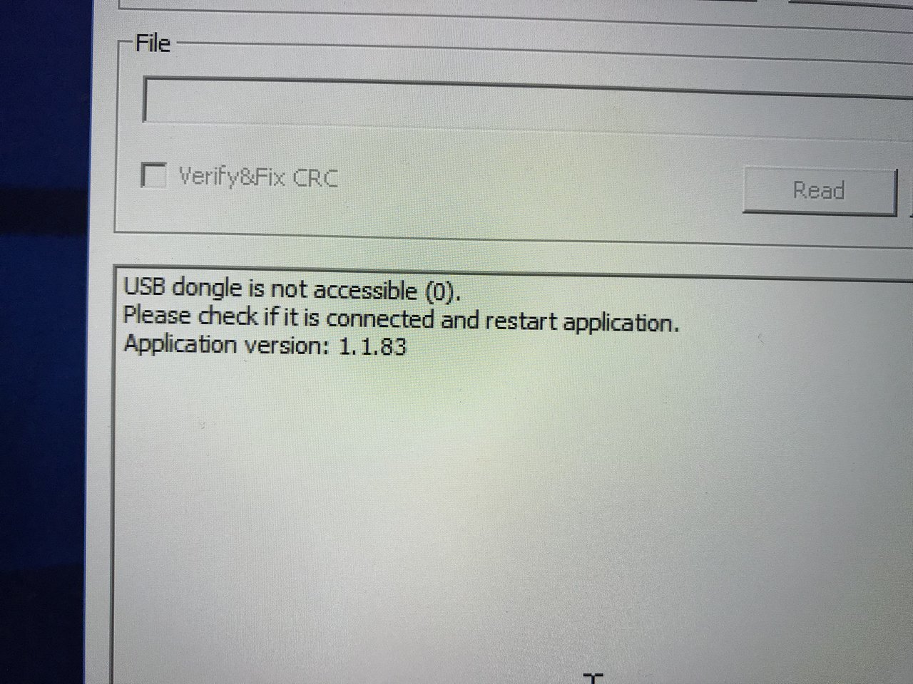

    18A47E0D-C582-4769-9976-E31A7F10A8DA.jpg @OVTune what am I doing wrong?
    All drivers installed with windows defender turned off.
    Per your instructions I’m suppose to get the Dongle serial number...

    Send him an email and he’ll get it fixed. I had the same problem.

    FML.....what did the fix end up being for you?

    I Just had to get the dongle registered. It’s a couple extra steps but not difficult at all.
