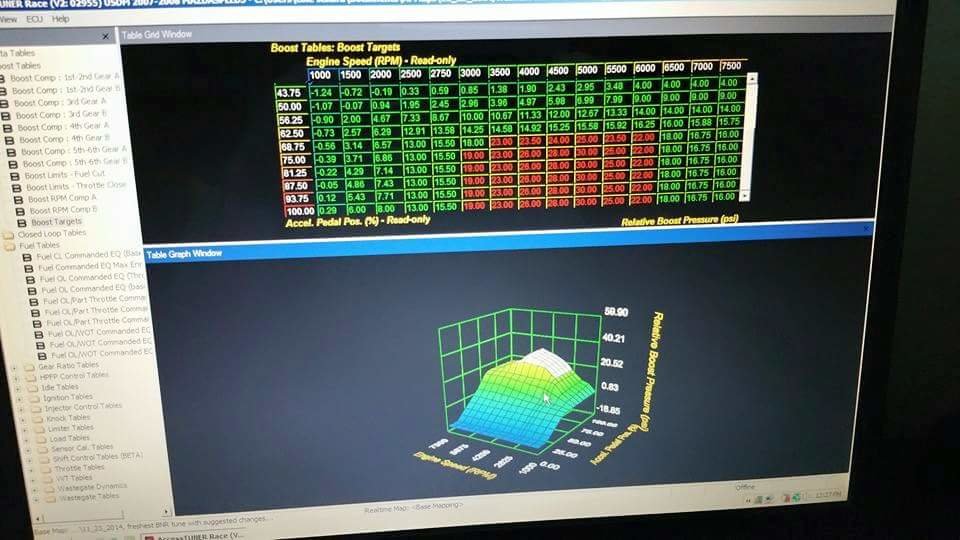

  18. Jan 6, 2018 at 6:22 PM
    #7978
    OVTune
    OVTune [OP] Well-Known Member
    Mar 27, 2017
    #214557
    8,112
    OVTune
    Upcoming update(s)
    A/T vehicles- 1.03
    - completely recalibrated throttle control.
    Valve Timing update
    Ignition massive update
    Throttle Torque
    Torque limit(s)
    Upshift update
    downshift update
    Converter Locking update ( decel )
    Transmission shift logic for learn "modes"
    idle airflow fix
    injection PI/DI crossover update
    Full throttle Torque Threshold for Throttle reduction update
    low RPM Load Limit - disable
    Base Ignition Retard map - Disable - 91 octane
    and some other things
    M/T Vehicles -1.03B
    04B10 ecu update
    Valve Timing update
    Throttle Torque
    idle airflow fix
    Will be setting up more dyno time
    turbos and other components were delivered today to begin our twin turbo build.
    Turbo choice is Garrett BB GT28R 0.64
    Treadstone TR12 front mount intercooler
    2inch hot pipe 3 inch cold
    Stock exhaust compatible downpipes
