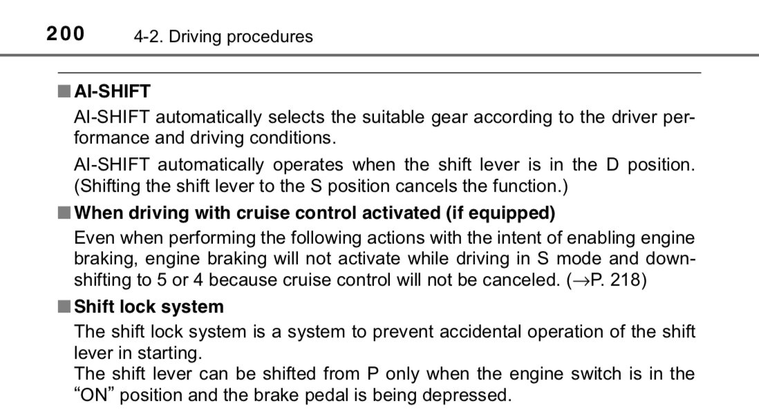

    The "artificial intelligence" aka learning is disabled when the Tacoma is driven in "S" mode. Right from the owner's manual, page 200:

    AT owners, tuners - Does anyone run the tune in S-mode exclusively? The learning has definitely been further minimized in 1.03 test I'm running, and Mat's further whittling it away. BUT, part of me wonders - why are we all freaking out on the "D" mode learning when in reality we should just be able to slide over to "S" just like the SSP owners do and lock in the post-flash shifting?
    Do any OVTunes ATs just run S-mode exclusively? I know no one WANTS to have to take an extra step each time you hop in your truck but if I could have my truck shift predictably each and every time with expert maps created by our very own OVTune, it's a compromise I personally would be willing to make especially combined with the incredible improvements in VVT, fueling, ignition, torque I'm experiencing on this test tune :)

    I use S-mode about 85% of the time (1.02C-A). Even in S-mode, the truck tries to get up into 5th gear WAY too early. I usually just use S4 so it can't get all boggy up in 5th gear just over 30 mph.
    One thing I can't stand in S-mode is the braking/decel/downshifting behavior. It is not smooth at all unless you are hard on the brakes. When slowing to a stop, you have to anticipate when the downshift will happen so you can let up on the brakes a little, otherwise the downshift causes the truck to lurch forward while braking. Not safe at all.
    I still have the SSP, but took it out a while ago. Might put it back in and see how I like it along with OVT. It's really easy to get accustomed to shifting to S instead of D. After a while it was automatic, so its not a problem at all.

    Interesting. Thanks for sharing. I do notice the decel / downshifts are more pronounced on S-mode but for city driving / traffic I find I hit my brakes a lot less when in stop/go kind of traffic. Interested, when Mat has time to learn more about what he's learned about S-mode b/c at one point he commented on how crazy fast the sample/refresh rate was in that mode. This always confused me a bit b/c I would have assumed S-mode is a bit more static. Another thing I'm not clear on is what "cancelling the learning" means exactly - does it carry learned values over from D, but just stop learning during that time or is it purely back to a "stock/standard" shift map. The world may never know...
