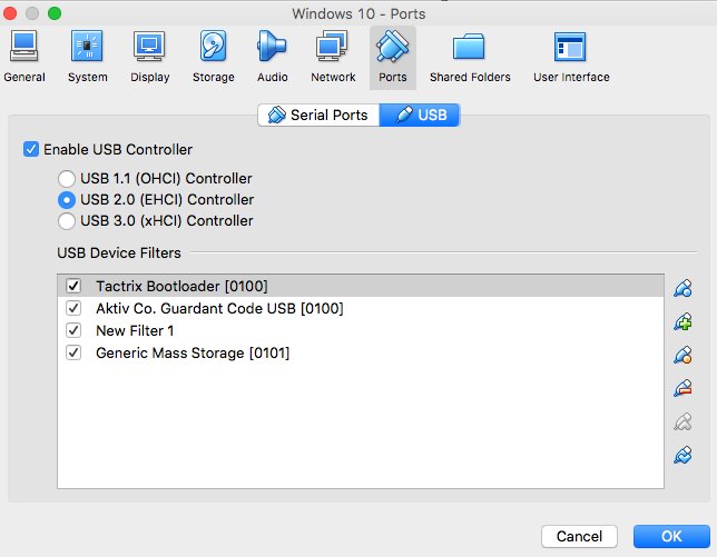

    Since it was brought up, is anyone using a a Apple laptop running a VM with windows? If so, can you share your thoughts?

    This is what I did and it has worked just fine. I just created a small Virtual Box for the Windows 10 Insider Edition and I use it exclusively for flashing and nothing else. And best of all, it was completely free... Takes some work up front and some tinkering sometimes to get it to recognize the USB devices but it DOES work :)

    Doing this as I type. You experienced no issues then?

    I have had a couple of issues with the VM recognizing the USB device but once you sort it out it worked fine for me.

    how did you sort it out? I'm having issues as well.

    I am running an old version of VMware fusion, at the top of the window for the VM is virtual machine, click that and one of the options is USB and if you go to that it has a list of devices to connect and the dongle was in there. That is how I have gotten mine to work.

    I had to plug in my dongle and Tactrix and from the setup for the VM you've set up, you go to Ports, make sure USB is enabled and set to USB 2.0, then hit the + icon to add your devices which should show as something similar to the top two in my list below. I had some weirdness with the order they were in on this list and the way it worked for me was to ensure the Tactrix was 1st then the dongle 2nd (ignore the other 2 as those are for thumb drives I added).
    Do this with your VM shut down just from the VirtualBox console, then save these settings and fire it back up and it should recognize (still need to download drivers and install per the directions once you're in Windows.)
