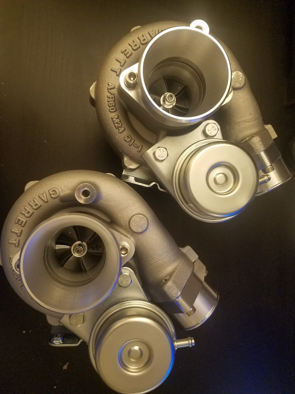

    Guys, the turbo isn’t any new news. Cmon I was banned when he posted this and I still kept up!
    See below

    I wish it were a supercharger instead, this still amazing.

    Turbos rule the world now days, way more efficient. Yes a little more complex an tuning isn't the easiest. But hey, that's Matt's problem not ours LOL!

    Less complex and typically less $$$

    And typically, supercharger have better low end power compared to turbocharger, which is what this truck need.

    That's the point of the twin turbo. Increase in power through all RPM's

    I selected the twin GT28Rs for their size and turbine housing (T25 0.64) so that we would be able to see boost as low as 2000RPM. When done correctly you will get the maximum possible low end torque from a turbo, way more than any supercharger can do.
    perfect example is the ecoboost 3.5L

    :eek:
    :fingerscrossed: One of those is mine. :cheers:
