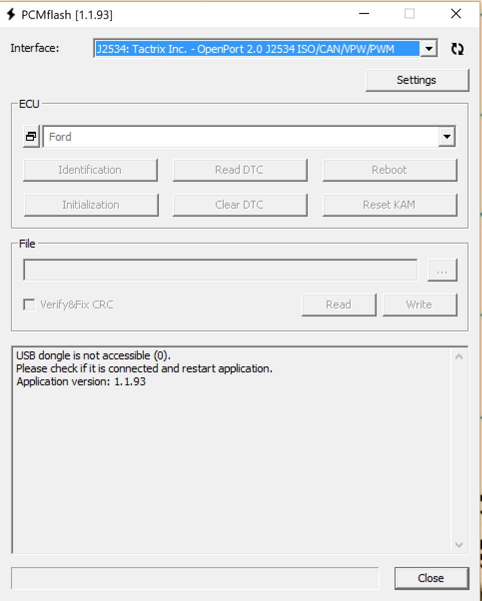

    Drivers installed? If so sometimes uninstalling and reinstalling helps, or swap USB ports, or some have even had best luck using a usb splitter

    Like @bshammer0 said, I uninstalled & reinstalled the Guardant drivers and that cleared my issue up. Also, make sure anti-virus programs are disabled & Windows firewall is off.

    Tried, uninstalling/reinstalling and killed all anti-virus and firewalls, still nothing. Just purchased a splitter to see if that'll work. Matt is supposed to be sending me another dongle as I've gone through all the troubleshooting tips with him already, but he hasn't responded to my email in about 2 weeks.

    Does windows even recognize a USB is connected? Are you certain your USB port works? Which version of Windows are you running?

    This. Need more information other than what you have posted.
    1. laptop model?
    2. version of windows?
    a. virtualized?​
    3. does device manager detect dongle?
    a. does device manager detect usb drive (any will do)?​
    4. connected to usb port or hub?​
    Answering these questions will help narrow down if it is hardware related or not.
