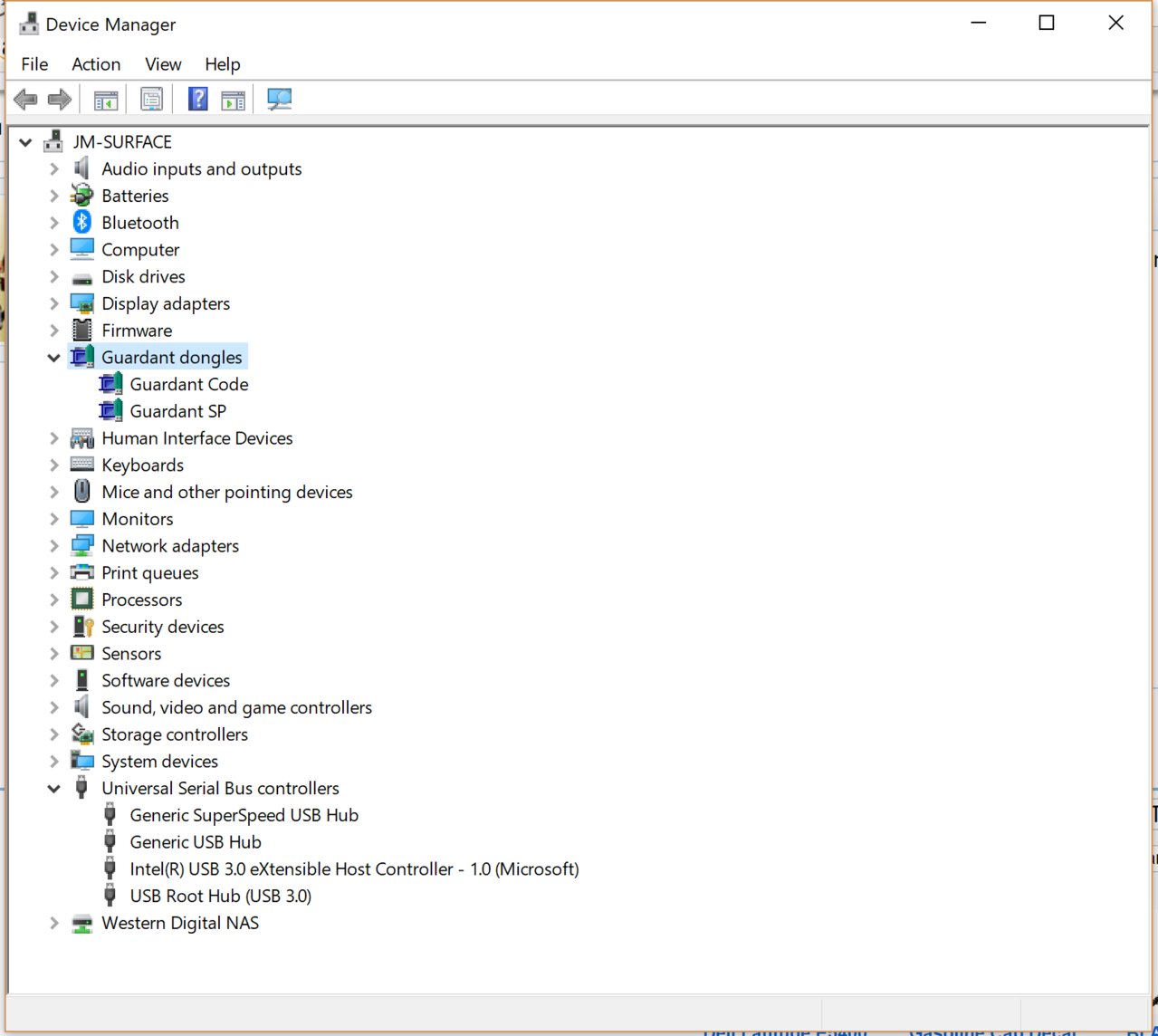

    Answered questions within the quoted text above. Everything shows correct until you open PCM flash. Based on messages from OVtune, I'm hopeful I'm in that group of people he's mailed a new dongle to, but he hasn't given me any confirmations. Here's a pic of my device manager if that helps at all.
    The only thing I can think of is that the dongle requires USB 2.0 and my USBs are both USB 3.0. I bought a USB 2.0 hub to test that theory. If that theory is correct, then guardant needs to upgrade their dongles.

    USB 3.0 ports are backward compatible with USB 2.0 devices. I tested it on my end with a setup similar to yours. Windows 10x 64 with the dongle plugged into USB 3.0 port. Even without activation, PCMFlash detected my dongle and displayed the serial number and version.
    Your computer is detecting the hardware. I can only surmise that the dongle has not been activated correctly hence why PCMflash cannot read it. Might want to go through the GrdTRU program again and verify that the dongle was activated.

    I had the same issue. Tried a splitter, hub, uninstall/reinstall drivers, etc. The computer detected the dongle and I could run the Guardant diagnostic utility on it. Everything showed up fine, but pcmflash could not access it. The only solution was to use a different computer.

    I beleave I had same problem,I downloaded file unzipped and antivirus would corrupt the file.i had to uninstall pcm flash and down load it zipped.do not unzipp
    until you disable antivirus, at this point no need for internet connection.
