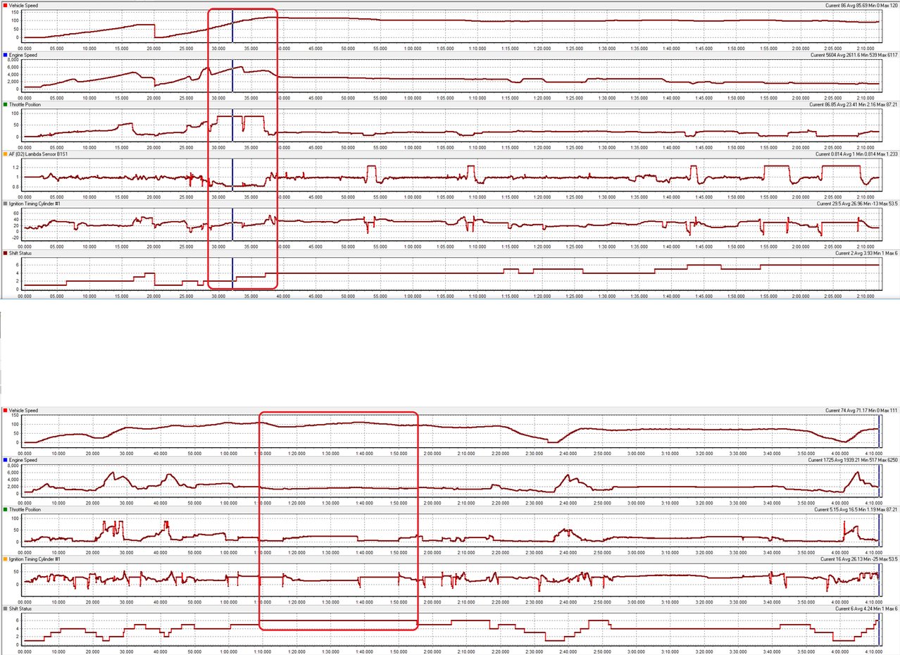

    Collecting some more data on our ignition calibration, running as smooth as butter
    Will have some graphs and log data tonight

    Okay folks a few things I want to show you,
    first the ability to actually accelerate in 6th gear. Here is a log driving, 6th gear from 55mph to 70 mph without a downshift and holding around 65-68mph.
    at highway speeds (55+) you'll see the truck go to 5th or 6th gear AND be able to hold the gear and produce necessary power / load to accelerate.
    You can also see on the logs ignition is much cleaner, the only areas with the dips are during decel when the engine cuts to ignition retard to help bring revs down. Other than that we are have very smooth and consistent ignition control.
    On the top you can see our peak ignition timing during a WOT pull is bumped up now to 29.5-30* on 91 octane, as opposed what you'd normally see stock around 19-21. This is actually better than the 2018 Camry can do now.
    Changes to the cam timing and ignition timing has given the truck much more response, where you can easily accelerate without having to go full throttle. You can see on these log images the majority of the time I do not need to go over half throttle to get right up to speed, quickly.
    During slower, city driving the truck will not race straight to 6th, but rather stop at 4th gear until you get more speed. You can see this on the bottom log, to the right a half throttle acceleration it will stop at 4th until you get to around 47-50mph. After that I put it in S mode 4th so you can see how smooth the ignition is.
