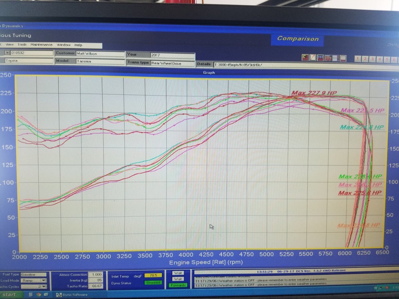

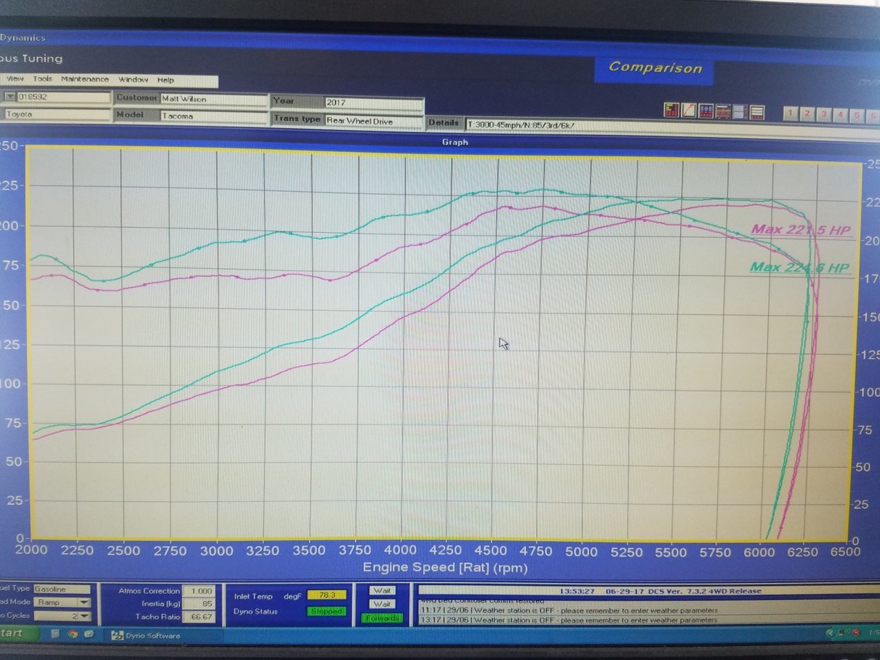

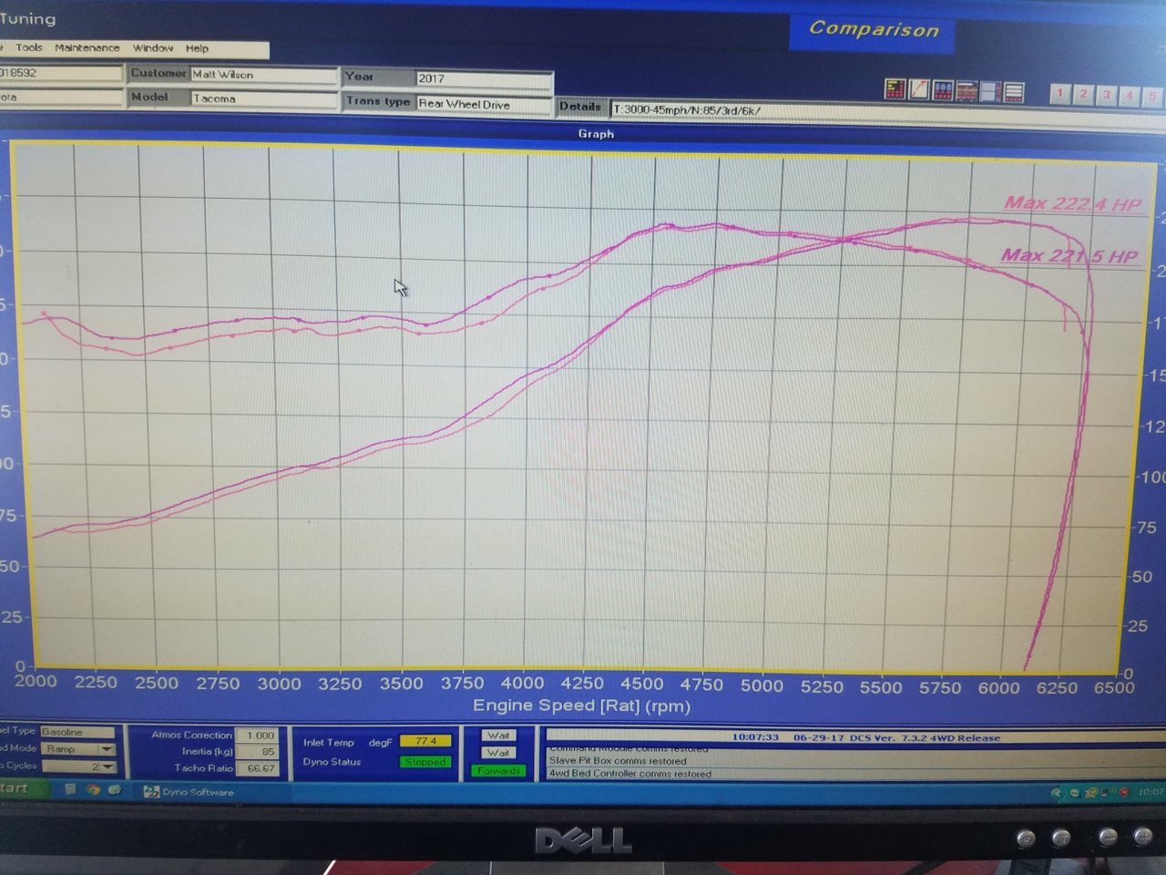

    Pink lines are stock HP / TQ. blue line is after tune. There is another graph that shows more changes / revisions as well which resulted in better top end gains. We chose to use that graph because it is what we ended with that resulted in the best / smoothest torque, however more top end gains are possible than what that graph shows.

    Just to get both of these together in one place to make it easier. . .
    Customer vehicle : 2017 TRD, stock, auto. (aftermarket wheels)
    some notable info
    Reflash and throttle development was our primary goal, while showing our base results on an otherwise stock vehicle.
    -stock rev limit (customer request)
    -main goal is improving throttle and transmission response
    - mid range power increase
    - not pushing the engine, (customer request)
    stock baseline of two runs put the truck right at about 221-222HP to the rear wheels.
    The engine power is surprisingly very similar to the 2GR FSE 3.5L variant in terms of peak torque and peak HP with a majority of power being up top, makes sense as it is a 2GR variant.
    notable info :
    - the engine simply can't breathe up top. logging maf rates, load etc with various changes to camshafts the engine in stock configuration really runs out of breath up over 5000.
    below about 4000 RPM we could see toyotas throttle ramping before full throttle (i'll try to get you a log snippet to show you), as previously explained it's part of toyotas new calibration code for "a flat torque curve."
    changes to the tune are:
    Alpha 91 octane reflash for stock rev limit
    ignition timing / fuel / camshaft / gearbox control / ECT throttle mapping / non ECT throttle mapping / torque limitations mapping and more
    -ECT adjustments and ECT throttle mode adjustments
    - non ECT throttle adjustments
    We did about 60-70 runs / drives collecting data in ECT / non ECT, etc so we could tailor throttle adjustments, which was more important to us and the owner of the car than just maximizing gains.
    here are some runs throughout the process showing increase of adjustments (not all of course)
    main adjustments to fix mid range torque
    overall:
    we see very large gains possible throughout the mid-range 20-30+ ft lbs increase from 2700 RPM onward, with midrange HP following suit.
    Top end gains (with only mild adjustments) around 8-9+HP increase on stock rev limit
    the focus: throttle adjustments and throttling control. (success)
    This was a great start to get everything moving along smoothly, verify some of our results and calibrate throttle mapping and ECT / non ECT throttle control maps, along with torque limit maps. This tune was not even "pushing" the truck / engine in any way. only very mild changes to top end with a main focus on changes to throttling / torque control maps and gearbox control maps.
    I think you guys are going to really, really enjoy the throttle difference you will feel with this reflash in ECT and out of ECT. Some of the changes are tailored to ECT mode specifically.
    I'll be back a little later to answer questions and see if I can pick through the data to show you guys further some of what is being talked about.
    I really think you guys are going to enjoy this. The throttle response changes alone, especially in non ECT mode are very, very noticeable.

    1.04. Kbro2s. ICONS.
  18. Jun 30, 2017 at 10:16 AM
    #978
    Reluctanse
    Reluctanse Granny shiftin, not double clutchin
    Apr 8, 2016
    #183699
    495
    Sam
    Newberg, Oregon
    '17 Tacoma DCSB Inferno TRD OR 6MT
    OVTuned, Grabbers, 5100s, Bakflip VP
    @OVTune
    any thoughts on this little guy here? do you think this dip is dyno quirks, or actual?
  19. Jun 30, 2017 at 10:18 AM
    #979
    EubeenHadd
    EubeenHadd Bit of a derp
    Jun 6, 2017
    #220828
    1,980
    Nick
    Indianapolis
    2005 T4R 4.7 AWD
    Encounter AT 32", OME 90021/885+63005/895
    IIRC, that was a dyno quirk. Reality sets in at 2500 RPM
