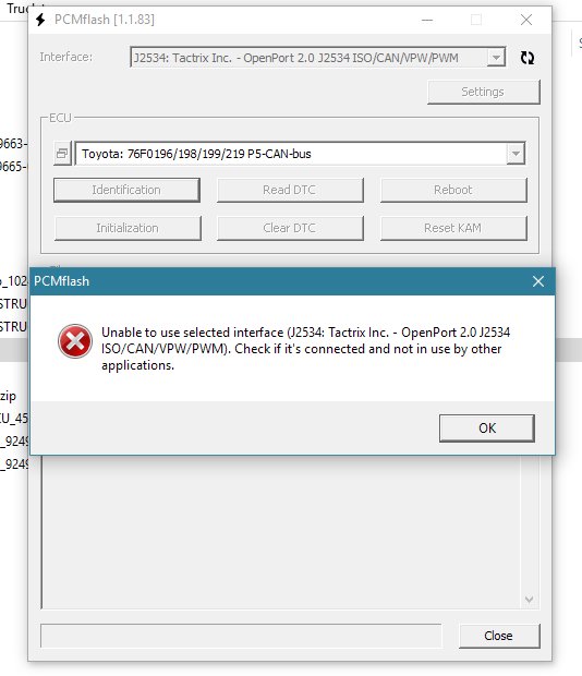

    I'm already licensed and running 1.02, but I can't identify from PCM flash anymore. I get this error. Also, I can't download the new PCM flash version as it says in google drive it has a virus and only the owner may download. error.jpg

    I had the same problem. No need for new PCM flash. Disable all windows defender and anti virus, reinstall tatrix drivers and guardent drivers.
