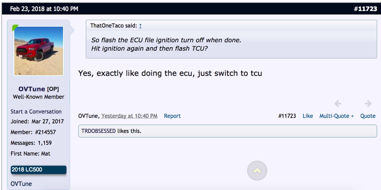

    I flashed them both the same way. Never changed the drop down to gear box. Someone asked a question about this last night and Matt just said do to everything exactly the same but with the different file. Maybe I took him too literally..but now I'm confused? My truck drives great.
    @OVTune Did I do it wrong? How am I still feeling all of the changes to the transmission?

    OVTune
    you must of somehow did it correctly or your truck wouldn't even run

    Thats weird. I'm 100% sure I did not change the drop down to the gearbox. I even checked it to make sure it was NOT on the gearbox option ha. Im going to reflash just in case, but the truck definitely runs good. Ive put 75-80 miles on it since last night.

    OVTune
    well if you only flashed the ECU, the truck will still drive fine. Just flash the TCU file for the other changes

    I flashed both. I even deleted the ECU file before downloading the TCU file, so I wouldnt get them mixed up on my desktop. I trust you though, since this is your baby. I'm just not sure how the truck runs and runs great. I got a success message after each flash, so I assume they both took.
    What would I notice from the TCU file? firmer/faster shifts? converter lockup? My truck is doing all of that.

    noob question, when flashing TCU file, gearbox P5 needs to be selected correct?

    2017 Cement Tacoma TRD Pro
    Yes

    Is there a difference if you flash tcu first and then ecu? Or does it have to be ecu first?

    Probably not - just seemed logical to me to write the ECU first and TCU second
